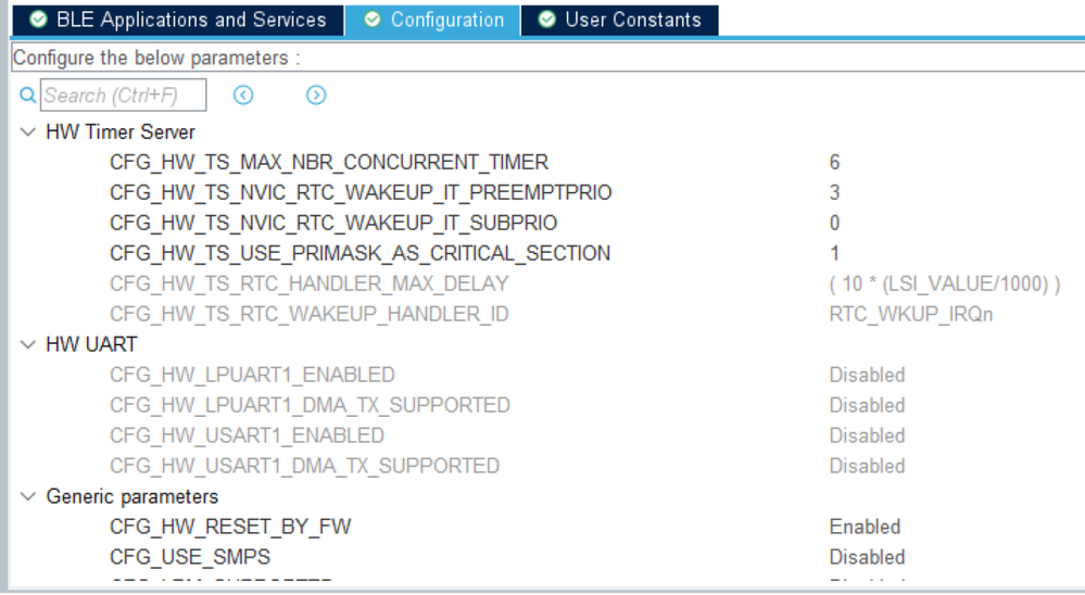

I have my own customized board based on STM32WB55RGV6. The board has HSE of 32 MHZ but don't have LSE. I am using LSI or (HSE/32) as RTC clock and HSE/1024 as RF wakeup clock. I am facing two different problems.
Case 1: First I tried with examples of BLE including BLE_P2P_Server, BLE_Custom and BLE_HeartRate from CubeMX. (Only change I did is disabled the LSE and hence LPM (low power mode) and relevant clock source setting). When I downloaded and tried to run the application, I always get HardFault from MX_APPE_Process(); more specifically when executing following
/* Execute the task */
TaskCb[CurrentTaskIdx]( );

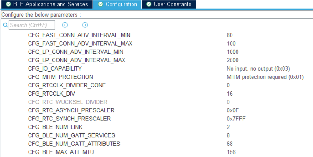

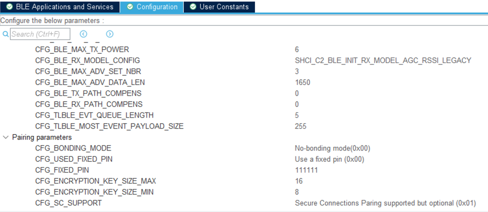

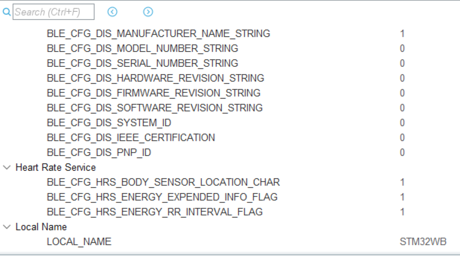

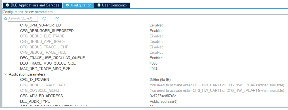

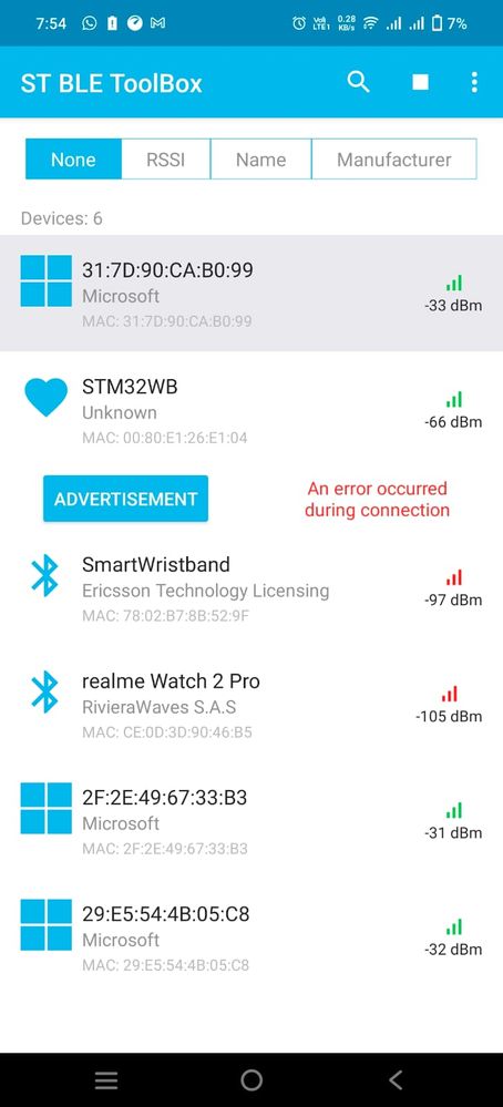

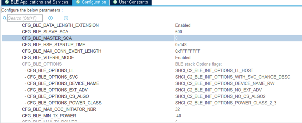

Case 2: Then after I tried to develop a project on CubeMX from scratch by selecting STM32WB55RGV6 chip (Not Nucleo board). I just made bare minimum settings with HeartRate sensor service just to see if it runs or not.
After downloading and running, I can see my device in ST BLE Toolbox android app but when I try to connect it with board, it doesn't get connected and gives an error like "An error occurred during connection".
I have attached few screenshots of the case 2 and I tried almost everything. what is wrong in case 1 as well as in case 2 ?
Note: I don't have even UART connection on the board so I can't see the trace on terminal. I kept trace disabled.
Kindly help me out.

Can you give the version of CubeMX and STM32CubeWB package you are using ?
Ensure you have the following configuration for CFG_BLE_LSE_SOURCE define in app_conf.h file:
#define CFG_BLE_LSE_SOURCE (SHCI_C2_BLE_INIT_CFG_BLE_LSE_CALIB | SHCI_C2_BLE_INIT_CFG_BLE_LSE_OTHER_DEV)

‎2022-07-27 8:13 PM
Thank you so much @Remy ISSALYS​ this really solved the issue. I forgot to enable calibration for the clock...
