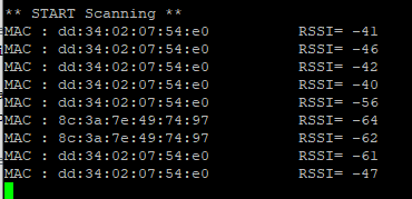

I'm using STM32WB to scan bel beacons, i started from p2p_client example and modified it to scan all types of beacons it shows all close devices, their MAC address and RSSI power, but i want to show more beacons info like beacon name, type, beacon temperture, etc.
Can anyone please tell me what to add in my code so that i can get all the beacons information?

                  printf("MAC : %x:%x:%x:%x:%x:%x"
                                    ,le_advertising_event->Advertising_Report[0].Address[5]
                                    ,le_advertising_event->Advertising_Report[0].Address[4]
                                    ,le_advertising_event->Advertising_Report[0].Address[3]
                                    ,le_advertising_event->Advertising_Report[0].Address[2]
                                    ,le_advertising_event->Advertising_Report[0].Address[1]
                                    ,le_advertising_event->Advertising_Report[0].Address[0]);
                  printf("          RSSI= %d\r\n",RSSI);

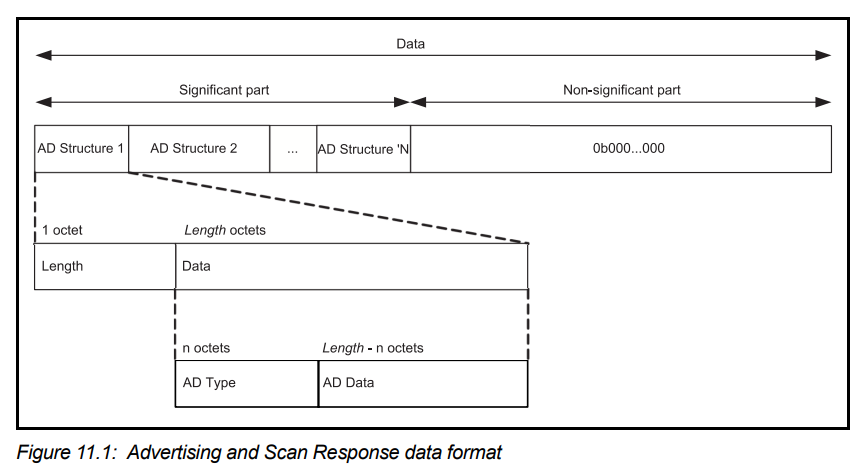

You have to parse advertising data (adv_report_data) to recover your data. Advertising data have the following structure (see BLUETOOTH CORE SPECIFICATION Version 5.2 | Vol 3, Part C) :
0693W00000Lx7I9QAJ.png You have to use this with different offset:
adv_report_data = (uint8_t*)(&le_advertising_event->Advertising_Report[0].Length_Data)+offset;
A description of each AD type is available in this document:
https://btprodspecificationrefs.blob.core.windows.net/assigned-numbers/Assigned%20Number%20Types/Generic%20Access%20Profile.pdf
Best Regards
