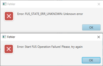

I am trying to load the p2p server example and noticed my Nucleo-WB15CC doesn't do any bluetooth communication. I can run normal user code just fine (LEDs, GPIO etc.) but CPU2 doesn't seem to do anything.
When I try to start FUS, I get this:

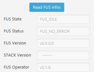

When I try to read the FUS version, I just get this:
Here is the output of some STM32ProgrammerCLI commands:
.\STM32_Programmer_CLI.exe -c port=SWD -fusopgetversion
FUS Operator Version  : v3.1.0
fusopgetversion command execution finished
.\STM32_Programmer_CLI.exe -c port=SWD -fusgetstate
FUS_STATE_IDLE
getFUSstate command execution finished
.\STM32_Programmer_CLI.exe -c port=SWD -startfus
Reconnecting...
Reconnected !
Error: FUS_STATE_ERR_UNKNOWN: Unknown error
Error: Fus is not yet running, try again
.\STM32_Programmer_CLI.exe -c port=SWD -startwirelessstack
Error: startwirelessStack Operation Failure! Please, try again

 I really don't know what to do at this point. I've already looked at other similar issues here, tried different connection and reset modes, I tried the boot0 bootloader method, I did a "factory reset" with this command:
STM32_Programmer_CLI.exe -c port=SWD reset=HWrst -w32 0x5800040c 0x00008000
And nothing changed. At this point I'm clueless, have I locked my self out of the CPU2?

Looking at the secure option bytes, SFSA is pointing to a previous version of the FUS.
Please use the startfus command and then read the FUS version using the fusgetversion command.
Let me know which version it is. If it is not higher than v1.2.x, then you have to upgrade the FUS with the latest version that you should find under \Projects\STM32WB_Copro_Wireless_Binaries\STM32WB5x.
In that case, depending on the current FUS version, I will tell you which FUS binary to use.
Once FUS is updated, the wireless stack will be correctly uploaded.

A few recommandations:
To know the FUS version, first do a StartFUS command and then issue a GetFUSversion command.
Looking at the secure option bytes SFSA and SBRV, you can guess whether the FUS or the Wireless stack is active.
If SBRV = 0x46000/4 = 0x18800, then FUS is active. 0xA000 is the space size reserved for the FUS in WB1x devices.

Remi QUINTIN
I had a look at the issue described in the other post.
To summarize, it looks like the SBRV value is the correct one. So, the FUS is active, and you should be able to send command like deleteFW or Program a wireless stack. despite the fact that the FUS version  looked weird.
Does the SBRV value change after deleting and installing a new SW, whatever it is?
