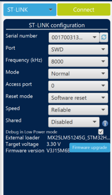

I cannot connect to the NUCLEO-WB05KZ with the CubeProgrammer. Also tried the "Under Reset" option, I'm always getting the same error message:
" Error: No STM32 target found! If your product embeds Debug Authentication, please perform a discovery using Debug Authentication"
How can I perform a discovery using Debug Authentication?

Coul you please try to connect this board using those parameters (and all other parameters combinations even debug in low power mode):
Also, Check the jumper positions: JP2 ON, JP1 on USB_STLK [1-2].

Hi Guys,
thanks for your comments! All jumpers were at their right position, but I additionally connected the JP1 jumper on the MB2032 MCU RF Board. I dont know if that was necessary?
After some trying with different settings and unchecking "Debug in Low Power Mode", I could connect to the MCU.
It seems it's working now!
