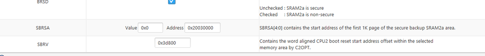

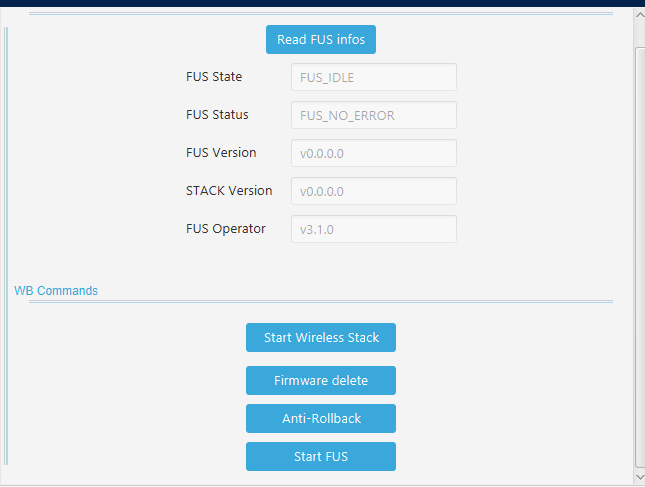

Hello, I am using a P-NUCLEO STM32WB Bluetooth 5 and 802.15.4 Nucleo Pack including a USB dongle.

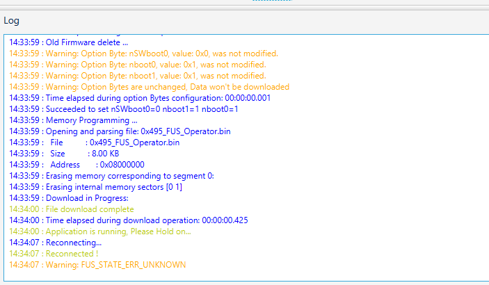

While trying to update the FUS of the USB Dongle to set up a Thread network, I encountered several errors.

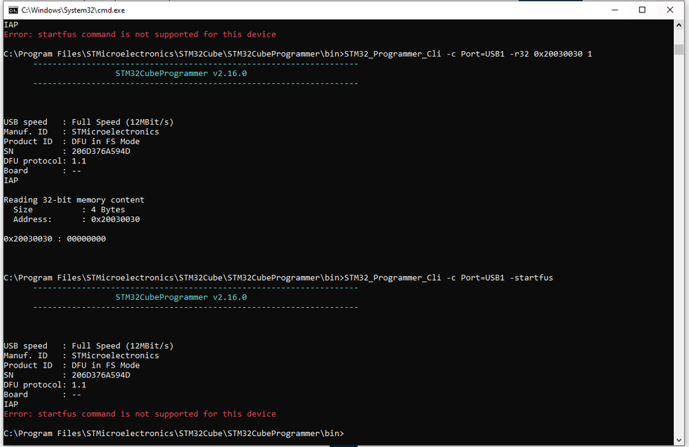

Initially, I was able to connect in DFU mode, but after attempting the update, Windows no longer detected the USB dongle.

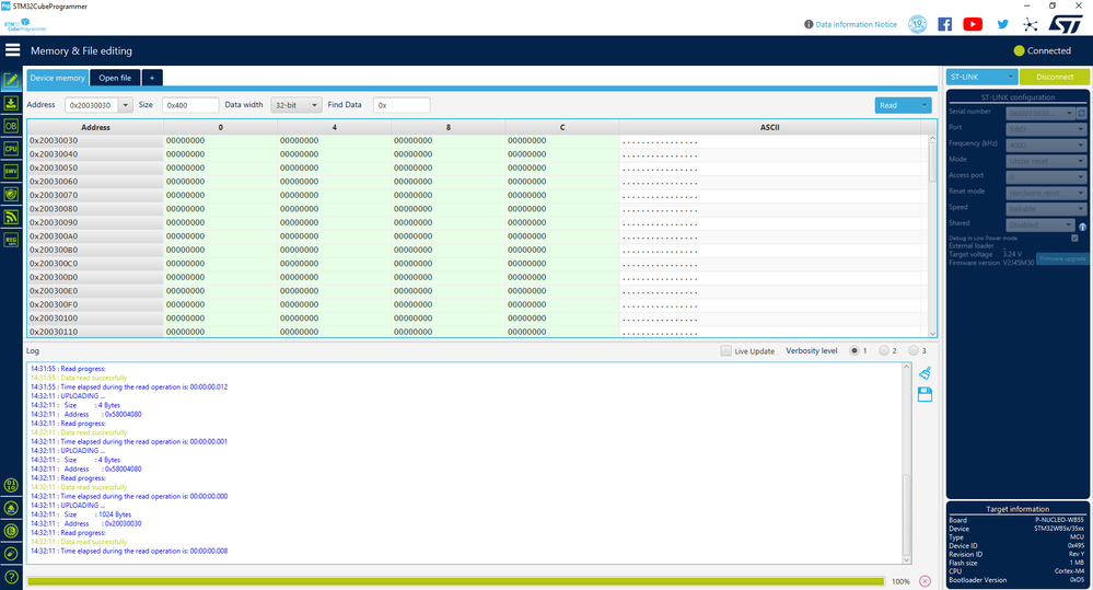

I then used the ST-Link to try to perform the update, but encountered these errors:
You can also find some informations related to the dongle.
Is it still possible to recover the USB dongle? Any help would be appreciated,

Hello @Marshall08
According to your screenshot, SBRV is equal to 0x3D800 that indicate FUS v0.5.3 is running on your board. So, you must update the FUS using the stm32wb5x_FUS_fw_for_fus_0_5_3.bin binary.
Best Regards.
STTwo-32
