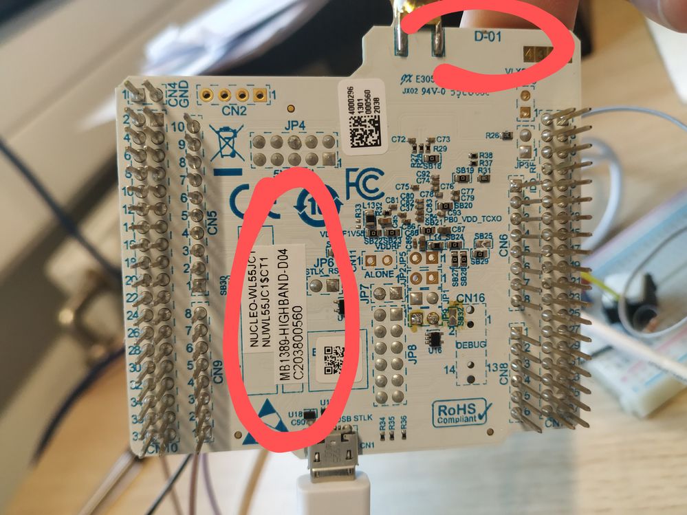

Dear ST community,
I have 2 Nucleo WL55 highband boards and I suspect that there has been a mislabelling of the device. As I am aware of, only the D-04 version of this board is sold. However, my board has several pins that do not correspond to the ones mentionned in the datasheet. By looking closely at my device, I see that the sticker label mentions the D-04 version, however, on the PCB itself I see D-01 (see image below)0693W00000ANckrQAD.jpg.
Is it possible to obtain the User manual and schematic for this version of the board? I cannot find it anywhere and it is really painful to probe each pin to reverse engineer the PCB connections.

Hello @BUdva.1​
Let me first welcome you to the STM32 Community :)
MB1389-D01 board was only internal boards used to prepare RF certifications. From those boards, the BOM has been tuned in order to have a MB1389-D04 BOM.
So, the revision D04 of the MB1389 which was RF certified, is the initially released version in production. And, I’m not in a favor to communicate schematic of MB1389-D01.
Regarding UM2592 which is available in the ST website, it is applicable (as the same) whatever the MB1389D boards.
Hope I answered your question :smiling_face_with_smiling_eyes:.

Thank you very much for the prompt answer, indeed it was an error from my side, datasheet is correct :)
Balazs
