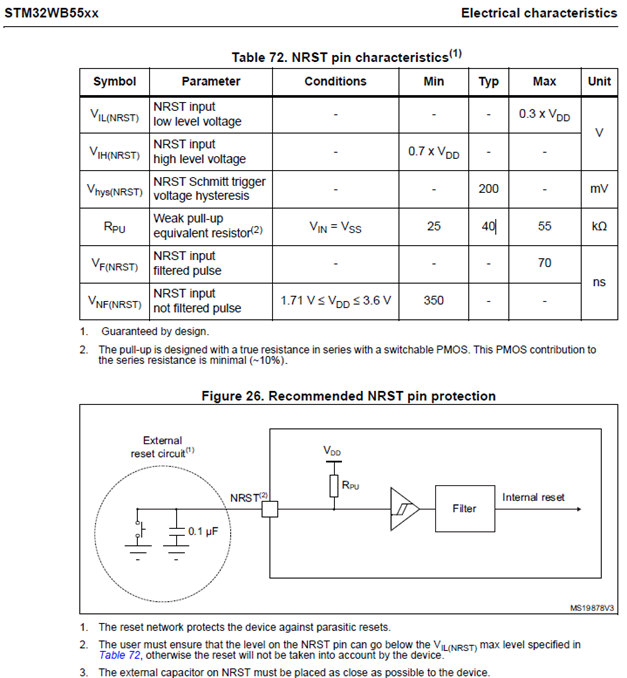

I would like to use a reset circuit with a push-button for STM32WB55 MCU. The datasheet of the MCU gives a diagram which is uploaded to the attachment. As I understand, I use just a push-button and a capacitor. VDD and pull-up resistor is involved internally. 0693W00000APSAJQA5.png

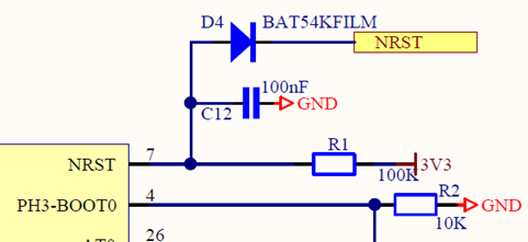

But, in many example schematics which is published by ST shows that there are a pull-up resistor and VDD connection externally. And sure, the circuit is connected by an active-low signal. So, I need a VDD with a pull-up resistor. 0693W00000APSCZQA5.png
The question is that whether I have to use a VDD connection with a pull-up resistor in the reset circuit or not necessary.

Hi @Batuhan A.​ ,
There is no need for a pull up for nreset:

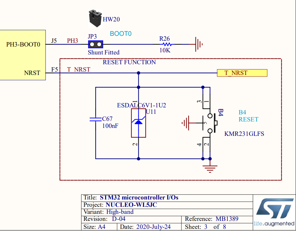

Hi, thank you for your comment,
The second schematic image is from "STM32WB55 USB Dongle" published by ST. It was confusing me.
I had a look at the STM32WL Nucleo board schematics. I do not use the pull-up resistor.
This is the relevant part of the board for other people for a quick check.
