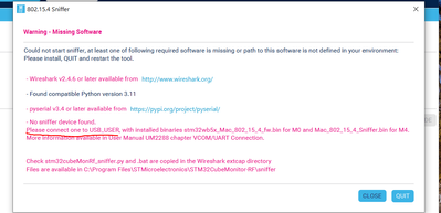

Hi Community,
I tried to connect and use 802.15.4 sniffer function from CubeMonitor-RF app. I stopped at the very first step. Once I opened the CubeMonitor-RF program, it said I need to install wireshark, after install the wireshark, the warning message is not changed. What should I do? Also I know how to install the binary stm32wb5x_Mac_802_15_4_fw.bin into the M0 core, however, how I can install the binary Mac_802_15_4_Sniffer.bin? There is no information about the start address for this binary. Do we have to use FUS to install this binary? When I tried to this install with FUS, it failed.
How I install the "pyserial?" I am lost how to do this.
Thanks in advance,
YJ

‎2024-05-14 10:28 AM
Hello @YJ99
I think that you should take a look at the UM2288.
For the Pyserial, you will find on the Internet a lot of tutorials on how to install it.
Best Regards.

‎2024-05-14 10:34 AM
Hi STTwo-32,
The document said " connect the STM32WBx5 Nucleo board to the host computer using the USB_USER connector." There are two micro-USB port and one is STLink port the other one is USER-USB port. Is the statement saying I have to connect to the USER-USB u-USB port. If I do, there is nothing happened.
Is it right we need to connect USER-USB not STLink-USB to use Sniffer?

‎2024-05-14 10:38 AM
Hi STTwo-32,
One thing I am still not sure is about the Mac_802_15_4_Sniffer_Nucleo.bin install. What is the start address for this FW and do I have to use FUS or just download the program into the flash?
Thanks,
YJ
‎2024-05-14 10:58 AM
The Mac_802_15_4_Sniffer_Nucleo.bin is the Nucleo Firmware. So, you have to download it using directly using CubeProgrammer.
Best Regards.
STTwo-32
‎2024-05-14 11:14 AM
Hi STTwo-32,
Is the start address would be 0x08000000?
Any other option do i need?
thanks,
YJ
‎2024-05-14 11:29 AM
I think it should be 0x08000000 with no other requirements.
Best Regards.
STTwo-32
‎2024-05-14 11:49 AM
Hi STTwo-32,
thanks for the info. One more thing is that do i have to connect USB-USER or STLINK-USB to connect P-Nucleo board to the PC?
Thanks,
YJ
‎2024-05-14 12:17 PM
I should be STLINK-USB to upload a firmware using ST-Link on Cube programmeur.
Best Regards.
STTwo-32
