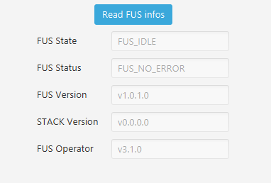

I have an STM32WB55CGU6 processor. I initially started with updated the FUS from v0.5.3 to v1.0.1 via the STM32CubeProgrammer.
This update was successful.

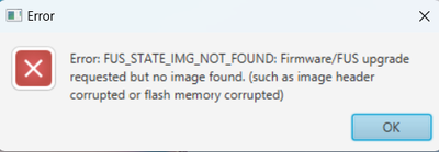

I then proceeded with trying to load the v1.2.0 FUS. However I got the following error:
After doing some digging I came across this post, https://community.st.com/t5/stm32-mcus-wireless/stm32wb-fus-update-fail-from-1-0-1-to-1-0-2/m-p/344015.
This says I basically locked my processor. However none of this information is available on the Release Notes.
Firstly why is this crucial information still not clearly visible on your Release Notes but rather hiding in this post regarding the locking of the processor.
Secondly how do I unlock the processor.

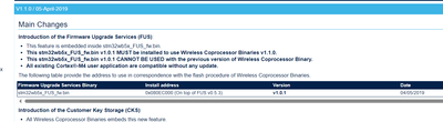

This is actually documented in the release notes related to the old revision of the cube package -
Anyway, FUS 1.0.1 was available only in the cube package version 1.1. Today there is 1.19 which does not contain the old FUS version but rather 1.2.0 which can be applied directly over 0.5.3. The basic requirement is to always use the latest versions.
For your second question, you cannot unfortunately unlock this device.
