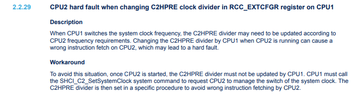

You issue can be related to several factors, such as: the memory allocation for SRAM2a, or BLE stack flashing sequence.
You can find more information in AN5289: How to build wireless applications with STM32WB MCUs
Check also if you have the same condition mentioned in the errata sheet.
Thanks
