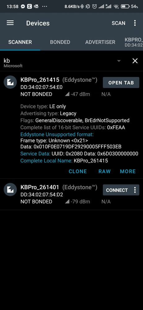

Yes, it is a Bluetooth sensor it advertises data like a beacon it's connectable so that the user can configure it (time of advertisment, data type ...)
this is his scanned data:
[BLE]   MAC : [DD]:[34]:[02]:[07]:[54]:[E0]   RSSI= -89
[BLE]   ADV_FRAME= 2 1 6 3 3 aa fe 12 16 aa fe 21 1 f e 7 1a d 29 e 0 5 ff f2 3 f3 a7 5d 93 6e
[BLE]   Frame_Type= 0x21 : Kbeacon
[BLE]   Vbatt = 3591mV Temp = 26.5 C Hum = 41.5% X:5;Y:-14;Z:1011

No it does not need a special configuration to connect, in fact i can connect to it using any android beacon app so it is connectable.
Are you sure you have all the connections parameters correct? : I don't know about that i've copied the same parameters from p2p_client example i don't know does it have to change when connecting to other devices other then stm32wb ?
"i can connect (sic) to it using any android beacon app"
Are you sure that actually establishes a connection?
Again, a "beacon" is generally something that does not connect, so a "beacon" app is likely just listening for the broadcast advertisements - not connecting?
You're going to have to contact the device manufacturer to find what settings it needs to connect.

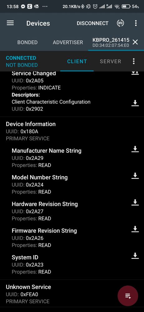

0693W00000NplwVQAR.jpg0693W00000NplwQQAR.jpgThere it is, it is connected like any other device and i can manipulate it's configurations
