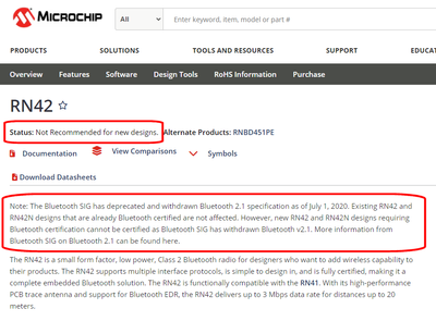

Note that RN42 is Not Recommended For New Designs (NRND) as it cannot be certified for new products:
