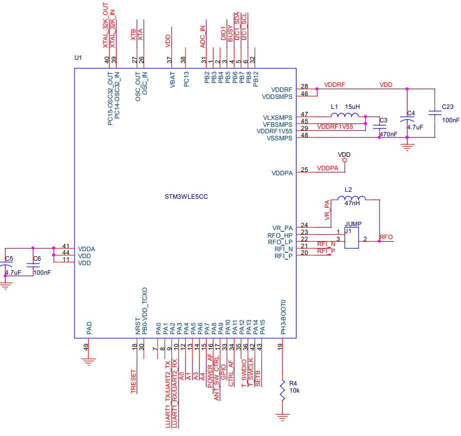

Hi all,
I cannot detect MCU STM32WLE5CC by ST-Link V2.
My schematic:
Could you show me my mistake? Thank you very much.

I don't see any label on wire going to pins 11,41,44 VDD/VDDA.

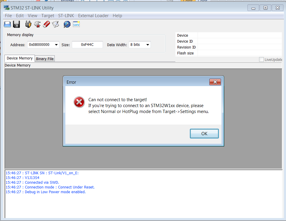

I'am sorry my mistake, but after i fix it, i cannot detect MCU, please see image below:
Mike_ST
I think ST-Link Utility has no support for STM32WL (die 0x497).
Please switch to STM32CubeProgrammer.

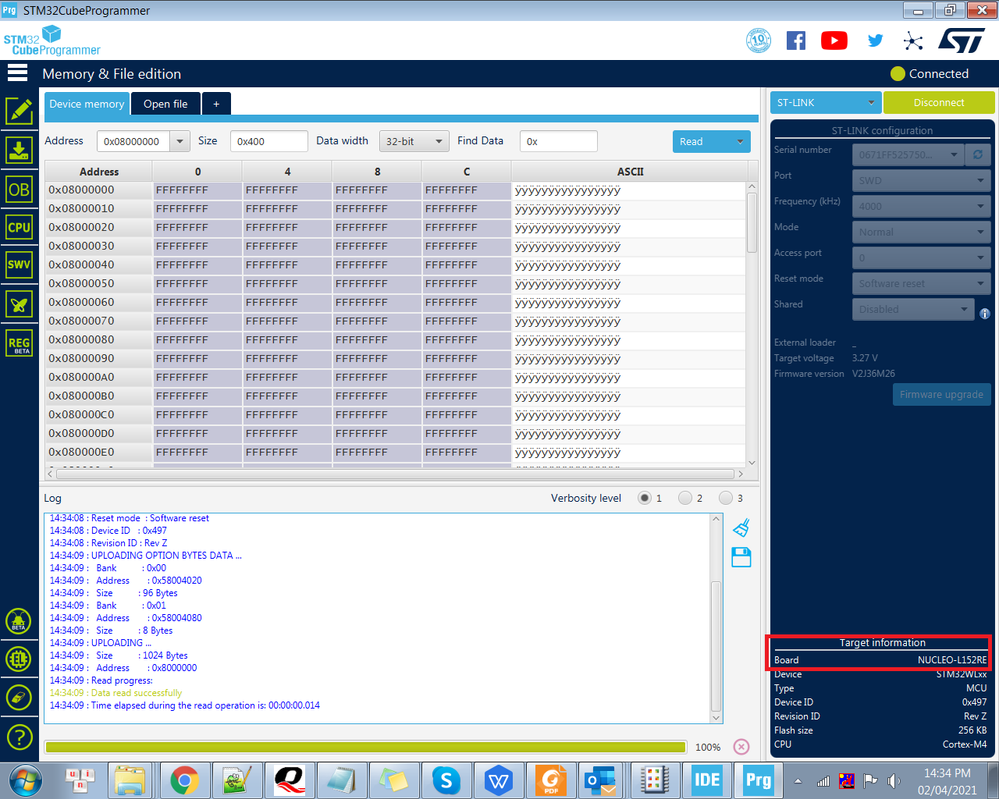

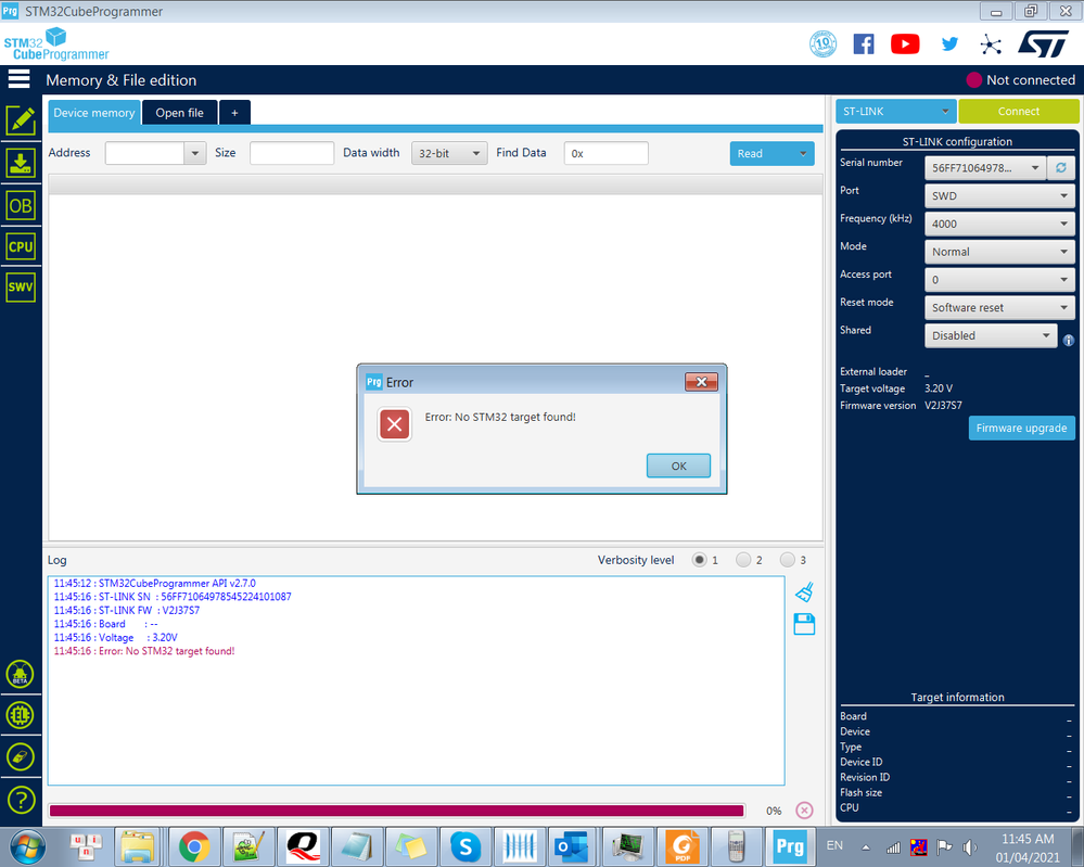

I tried with STM32CubeProgrammer.
Thank Mike,
It is ok, I tried with another st-link (st-link from Nucleo kit).
