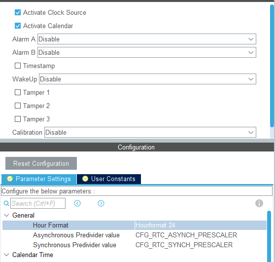

Hey folks,
I'm having issues with the RTC's calendar function while using BLE.
I would like to timestamp recorded data using the calendar function of the RTC and then transmit that data over Bluetooth. However, when I enable the Bluetooth middleware in Cube, it forces the ASYNC and SYNC prescalers of the RTC to predetermined values of 0xF and 0x7FFF, respectively. See image.0693W000004KVwMQAW.pngIs it possible to use the calendar function while using BLE? If so, how?

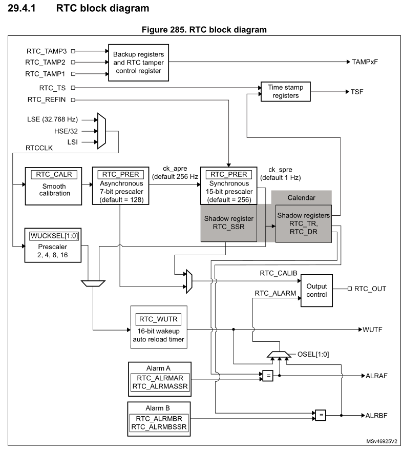

Thank you @Remi QUINTIN​  for you response - glad to hear that it is being looked into. When you say "optimal", are you referring to power consumption of the MCU or are you suggesting that some applications may not work as intended?
My proposed workaround would then be to change it to this:
 #define CFG_RTCCLK_DIVIDER_CONF = 16
See below the expanded code snipped from app_conf.h and the RTC block diagram from the reference manual below.

0693W0000058yXQQAY.pngChanging CFG_RTCCLK_DIVIDER_CONF to 16 would mean that CFG_RTCCLK_DIV remains 16, therefore not affecting the CFG_TS_TICK_VAL timing. In addition, the CFG_RTC_ASYNCH_PRESCALER remains the same (value of 15). Effectively, only the CFG_RTC_SYNCH_PRESCALER is modified to a value that produces a 1 Hz clock for the calendar functionality. As far as I can tell from the block diagram, nothing but the calendar (and maybe RTC_CALIB) should be affected by this change.
Could anyone verify my logic? Or am I perhaps missing something?

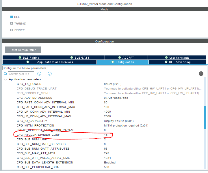

Hello!
In STMCubeMX you can set the CFG_RTCCLK_DIVIDER_CONF value in the BLE settings. This way you don't have to redefine its value for each code generation. I attached a picture of the setting option.
Hope I could help!
Sincerely, Ferenc Braun
