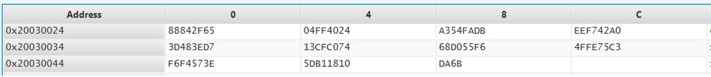

I'm using a custom board with STM32WB55 and faced with an issue related to FUS up and running. Initially, I was able successfully to upgrade FUS up to 1.1.2.0 via swd interface. Then I have updated the user key via USART embedded bootloader. Started from this point everything works fine until I performed the power cycle. After that, FUS stops working. When I'm trying to read FUS info I get "0x20030030 : EFF742A0"
Before getting FUS info I always send STM32_Programmer_CLI -c port=swd -fusgetstate command several times and it replies "FUS_STATE_IDLE" every time.
Read back DIT table shows results as follow:
0x20030024 : 88842F65 04FF4224 E344FADB EFF742A0
0x20030034 : 3D4C3EF7 13CFC074 68D055F6 6FFE65C3
0x20030044 : F674573E 5FB11850 C24ADA6B ACBB243B
0x20030054 : 4206EEED

I have IPCCDBA = 0x0000, and DIT table seems placed in a correct place:
r ap 0 @0x20030000 0x00000004 bytes Data 0x20030024
I'm using CubeProgrammer v2.7.0: in according to AN5185:
"When using the SWD interface with the STM32CubeProgrammer (STM32CubeProg) older than V2.7.0, the address of the device information table is located at 0x20030890. For STM32CubeProgrammer V2.7.0 and higher, the device information table is located at 0x20030024."
So, FUS version should be located at 0x2003030. Or I miss something?
Reading DIT table I get result as follow:

Indeed, you're right. the DIT shall be located at 0x20030024. In that case the FUS version is weird!!

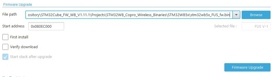

During the first try of FUS upgrade up to v1.2.0 I got en error "FUS_STATE_ERR_UNKNOWN" after the second try it shows "Firmware Upgrade Success" but FUS version still broken.

When you say "FUS is still" broken, do you mean the FUS version still looks weird despite the "Firmware Upgrade Success" message?
I will discuss with the security team about those strange numbers reported for the FUS version.

Yes, FUS version still looks weird.

Do you mean put stm32wb5x_FUS_fw.bin starting from address 0x080EC000? If yes, it didn't help.
‎2021-06-08 10:30 AM
No I was thinking about loading the M0+ FW
