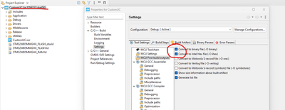

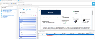

select the example customUC
change settings to generate bin and hex file

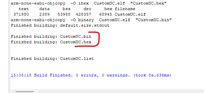

compiled successfully without any error or warning

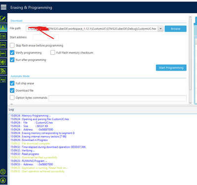

flash the hex file successfully
but on the board seems nothing is running, no LED blink, no UART connection in device manager.

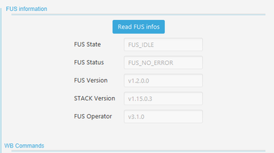

Update:
after I flash StevalAstra1B_BLE_Ota_1.15_LSE.hex  at address 0x08007000, it´s working
then it shows me the original problem
