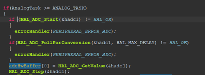

Hi community,
I have an application to sample the ADC and go to sleep(STOP2) mode. From the RM0434 got to know that cannot use the ADC/DMA interrupt as a wakeup source to get the ADC converted values
So I went with the Polling approach as shown in the snapshot. ADC_PollForConversion function is always giving HAL_Error. Can I get some help with this?
This code snippet is the ADC Init function. Also planning to use multiple channels going further

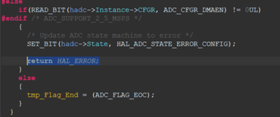

‎2024-08-22 3:36 AM
This is the place where HAL_Error is returned
‎2024-08-22 5:33 AM
Okay, so it sees that DMAEN is set, which it shouldn't be for polling mode. Find out where/why that's being set.
> hadc1.Init.DMAContinuousRequests = DISABLE;
This should make it disabled. Perhaps there is more relevant code that is not being shown?
