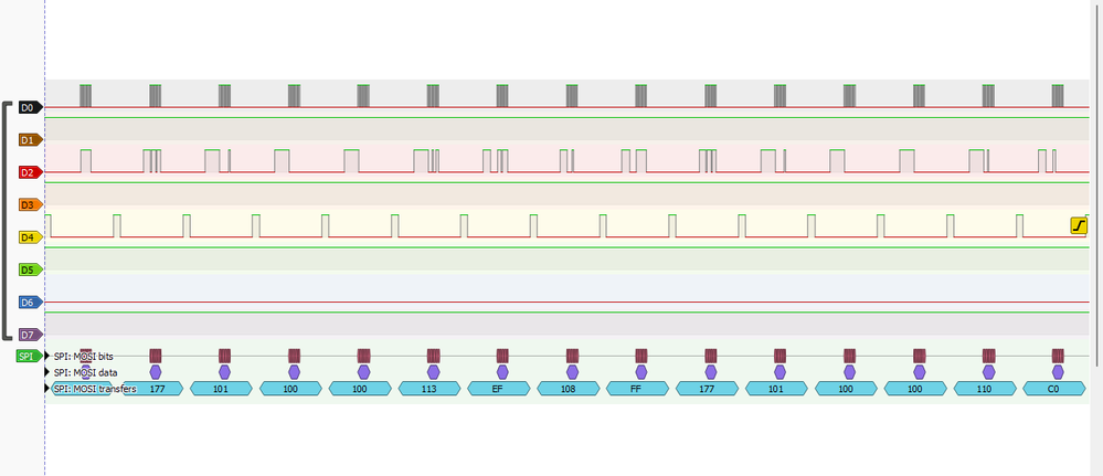

I am using an ST7701S LCD over 3-wire SPI (CS, SCK, SDA) with my STM32.
When I send the initialization commands from my ESP, I noticed the following:
  • The first command of the sequence is not sent.
  • The program seems to stop at the second stage, around the 100th command.
SPI is configured in master mode, polling (no DMA, no interrupts).
Example of the write function:
void ST7701_Write(uint8_t dc, uint8_t data) {
uint16_t value = ((dc & 0x01) << 8) | data;
HAL_GPIO_WritePin(LCD_CS_GPIO_Port, LCD_CS_Pin, GPIO_PIN_RESET);
HAL_SPI_Transmit(&hspi2, (uint8_t *)&value, 1, HAL_MAX_DELAY);
HAL_GPIO_WritePin(LCD_CS_GPIO_Port, LCD_CS_Pin, GPIO_PIN_SET);
Questions:
  1. Could the first command being skipped be due to HAL/SPI initialization or state?
  2. What is the recommended method to ensure all commands are reliably sent over 3-wire SPI to ST7701S?
Thank you for your help.

Hello @Ameni
Did you check with the logic analyzer if the first command is really sent or not?
Saket_Om

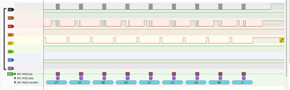

Hello @Saket_Om,
Yes, I checked with a logic analyzer.
In fact, the behavior is the following:
  • The very first SPI frame after reset is not transmitted (it does not appear on the bus).
  • The following frames are correctly transmitted up to a certain point.
  • As soon as a HAL_Delay() is executed in the sequence, no more frames are sent after that (the SPI bus remains completely inactive).
This behavior is exactly the same whether the LCD is connected or not, which suggests that the issue is not related to the ST7701S driver itself but rather to the STM32/HAL/ThreadX layer.
On the attached logic analyzer capture, we can see:
  • the missing first frame,
  • then valid SPI frames,

Hello ,
Sure, I will share a minimal test code and the logic analyzer capture.
I attached:
  • a screenshot from the logic analyzer showing the SPI frames,
  • and a reduced test code used to reproduce the issue.
This test gives the same behavior:
  • first SPI frame is missing,
  • SPI stops after HAL_Delay(),
  • and the result is identical whether the LCD is connected or no

However, when running without the debugger, the behavior is different:
  • and after HAL_Delay() no more SPI activity is observed on the bus.
So the issue seems to be timing-dependent:
the presence of the debugger changes the execution speed and makes the problem disappear.
