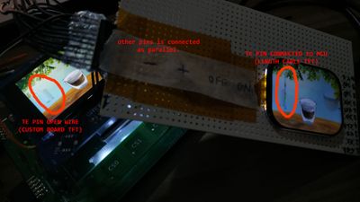

I set a flag, and checked it in handleTickEvent of any page. I give new location to images when the flag is set. I have a problem in this point. Sometimes(approximately 1/50 flag set), i see random color on some pixels. I research this problem at now. Do you have any idea about this problem? If i can find source of this problem, i will think the solution.
I need to ideas about source of this problem.
I have take many photos about this problem. You see that in following SS.

I probably caught the problem. I used double TFT that one of them is on custom board and other one connected by cables about 200mm lenght. And I connected as parallel each other without TE pin. I only used the TE pin of custom board TFT. And this problem solved. Probably, Pin's cables should not be length.
In following SS:
TFT that is connected with 200mm length cable, TE pin was connected to MCU. Custom board TFT has clear image but there are random pixel colors on TFT that is connected cables.
I hope this information may help otherones.

Custom board TFT(MCU): ST7789V
Other(connected with 200mm cables) TFT(MCU): ST7789P3

I tested many hours. Yes, when I abridged the all of data cables, this problem is solved. I didn't run into again with this problem. I waited the test results for feedback. If I run into the any problem like this, i will write here again.
