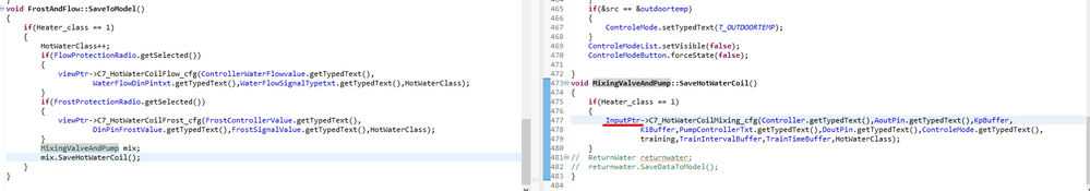

Hello, I want to ask why simulator turn off when I call function in other class like that:

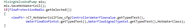

When I call a function in another class and set pointer to other screen it crashes:
But if I not use one of them it working fine

Not easy to help with what you shared without the context of those functions/code. I mean if it works fine without calling them then it comes from the function themselves.
Share the log file as well because "simulator" crash is too vague once again, or better the project itself so that other users can replicate it.
Is it only the simulator that crashes as well or do you also hit hardfault on target ?

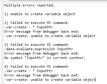

If it crashes on target then it is not just the simulator but the function itself then. What do you see when you debug ?

‎2023-02-01 1:32 AM
When I call a function in another class and there are also pointer which goes in to same screen as first one. I marked red where crashes
‎2023-02-01 3:53 AM
@Romain DIELEMAN​ After debugging I found out that my pointer is 0. What can cause this problem?
