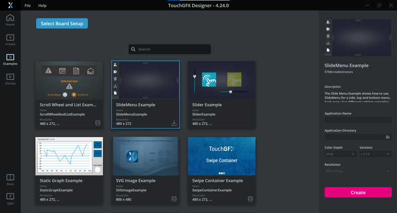

I need a dropbox list widget and can't seem to find one in the toolkit.
1. Are there 3rd party vendors that offer this or other UI elements?
2. Can the existing widgets be assembled to implement a dropdown list widget?  If so, can you please explain the steps to a novice?

There is a widget called Slide Menu that can implement the functionality you are looking for. You can refer to the example project available in the TouchGFX designer to learn about it usage.
Slide Menu exampleSlide Menu example
I hope this helps you!
Mohammad MORADI
I've seen these examples, but they do not address the problem I have, which is limited screen real estate to implement a slide menu. I would like the functionality of a dropbox list because it takes up much less space. Can ST help me find a solution?

While we wait for @alanoatwork 's answer, I have made a simple drop down menu workaround example using a scrollList.
Please find the example attached.
