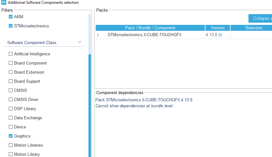

why does cubemx V5.5 remove STemwin and TouchGFX part ?
‎2020-01-08 9:58 PM
why does cubemx V5.5 remove STemwin and TouchGFX part, will it move back? how can I use this part conveniently?
Solved! Go to Solution.
‎2020-01-13 2:34 AM
Please read the sticky on X-CUBE-TOUCHGFX-4.13.0 and how this affects TouchGFX in CubeMX 5.5.0.
/Martin

‎2020-01-13 4:44 PM
what will ST do with the STemwin, will it be abandoned ?, or if I want to use will never get update ?
‎2020-01-14 6:21 AM
You can still use it for a while, but it won't be usable through CubeMX again.

‎2020-01-29 6:32 AM
@Martin KJELDSEN​ and if I have a board (F413H) what will do now without STemWin?
‎2020-01-30 12:47 AM
You can still use STemWin, it's just not a part of CubeMX anymore - It should be avaialble from the Cube firmware packs.
‎2020-03-04 4:10 PM
now here comes V5.6, I still cannot find where is the STemwin, can you tell me where can I find in the newest version?
‎2020-03-04 11:59 PM
Same answer as before. STemWin is not a part of CubeMX anymore. It's delivered through the CubeFW packs.
