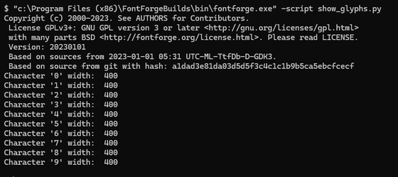

You can modify with a python script. FFPython.
CLI>> "c:\Program Files (x86)\FontForgeBuilds\bin\fontforge.exe" -script show_glyphs.py
import fontforge
def print_width_digits ():
    # Numbers '0' - '9' ie 48-58
    for digit in range ( 48, 58 ):
        glyph = font[digit]  # Get glyph by character
        if glyph.unicode != -1:  # -1 means the glyph has no Unicode mapping
            char = chr(glyph.unicode)
            print ( f"Character '{char}' width:  {glyph.width}" )
        else:
            print(f"Glyph name: {glyph.glyphname}, Unicode: None")
# Open the font file
font = fontforge.open("font.ttf")  # Replace with your font file
import fontforge
        else:
