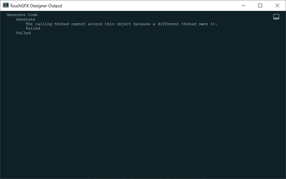

What could cause this compile error: " The calling thread cannot access this object because a different thread owns it?"
‎2020-02-03 1:21 AM
I have tried to generate a new project via the templates in TouchGFX for STM32F429-discovery. I have also tried to create a create a project via STM32CubeMX 5.5.0 for the same board and followed the guide https://touchgfx.zendesk.com/hc/en-us/articles/360010921760-TouchGFX-HAL-Development.
Every time I hit the "generate code" in TouchGFX the result is "The calling thread cannot access this object because a different thread owns it." What can cause this failure..? Is it the tool, code (not modified by me) or Windows 10?

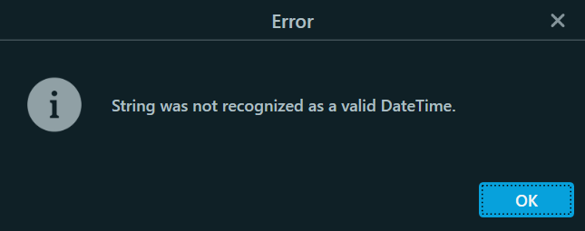

Bonus error; I also have the "String was not recognized as a valid DateTime." This one I know how to solve, but I don't know if they are linked...

Can you supply the logfile from %APPDATA&/TouchGFX-4.13.0/ ?

There it is. Thanks. Checking!
‎2020-02-03 3:33 AM
It seems only to be a problem with the blank template. The one with bubbles works fine.
‎2020-02-03 3:45 AM
Oh, is that so? Interesting.
Took a look and it seems it's an error that may be masking the DateTime error because they happen so close to eachother. I'll think about it.
