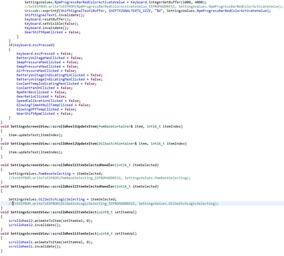

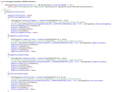

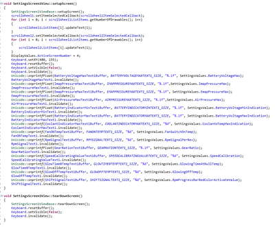

Hi everybody!
I implemented a keyboard into my project. (I tested the keyboard widget in a separated project, and it worked well).
If I use the keyboard in my dashboard project, it make weird things.
If i entry a value, i write to the eeprom(M95320). If is restart the dashboard, i read all eeprom value.
On the "Beállítások 1" screen work perfect the keyboard and value entry.
But on the "Beállítások 2" doesn't it work good. The end of the video you can see this.
Keyboard text area wrong and when(2:29) i entry a value to "Levegő tartály szorzó", then change the values some textarea to zero and "Emap nyomás szorzó" will be 5.0.
I don't know where to look for the error, but it's very strange that it doesn't always do it.
Here is the video:
Youtube video
Thanks!

Place code as code no images
Unicode::snprintfFloat(buffer, 20, "%6.4f", 3.14159f);
// buffer="3.1416"
and check all printed is floats and  buffersizes is ok.
I checked all buffersizes and printings.
Why does it at first entry to screen. I dont know where should i search the error/errors.
And why good the "Beállítások 1" screen.
From your code is not clean how keyboard select active object = impossible to help.

Place breakpoints into all that go to zero. Seems your touch set multiple true ...
And maybe use if keyboard isvisible return... as first line

			Keyboard.escPressed = false;
			BatteryVoltageMultipleClicked = false;
			BatteryVoltageOffsetClicked = false;
			ImapPressureMultipleClicked = false;
			ImapPressureOffsetClicked = false;
			EmapPressureMultipleClicked = false;
			EmapPressureOffsetClicked = false;
			AirPressureMultipleClicked = false;
			AirPressureOffsetClicked = false;
			AccelerationMultipleClicked = false;
			AccelerationOffsetClicked = false;
void SettingsScreen2View::BatteryVoltageMultipleButtonClicked()
	Keyboard.setVisible(true);
	Keyboard.invalidate();
	BatteryVoltageMultipleClicked = true;
void SettingsScreen2View::BatteryVoltageOffsetButtonClicked()
	BatteryVoltageOffsetClicked = true;
void SettingsScreen2View::ImapPressureMultipleButtonClicked()
	ImapPressureMultipleClicked = true;
void SettingsScreen2View::ImapPressureOffsetButtonClicked()
	ImapPressureOffsetClicked = true;
void SettingsScreen2View::EmapPressureMultipleButtonClicked()
	EmapPressureMultipleClicked = true;
void SettingsScreen2View::EmapPressureOffsetButtonClicked()
	EmapPressureOffsetClicked = true;
void SettingsScreen2View::AirPressureMultipleButtonClicked()
	AirPressureMultipleClicked = true;
void SettingsScreen2View::AirPressureOffsetButtonClicked()
	AirPressureOffsetClicked = true;
void SettingsScreen2View::AccelerationMultipleButtonClicked()
	AccelerationMultipleClicked = true;
void SettingsScreen2View::AccelerationOffsetButtonClicked()
	AccelerationOffsetClicked = true;
Yes, you're right! The if branch was executed more than once. I edited the code logic.
 (with eeprom write and read are good too)
Already only one error, with keyboard only on two screens.
Keyboard Textarea ???
