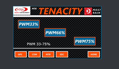

I've setup a project in TouchGFX4.18.1 and STM32H747i Disco, which consist of 4-5 screens. One screen is for motor control. In this motor control screen 3 buttons are used (low, medium, high) for changing the PWM. Simple but, the virtual function at the model (MVP) is calling the wrong Function.
The funny thing is, the order that a function is placed in the .HPP yields that the function to be called in model and it's not the correct function. I've used breakpoints throughout MVP, and all was validated as making the incorrect/correct call.
virtual void PWM_33(); (if PWM_33 is placed on the bottom, PWM_66 would be called for every button.)
virtual void PWM_66(); (same as the above)
virtual void PWM_75(); (same as the above)
This is the third time I've made the to change to the buttons that only yield the same results. Otherwise, each function call reverts to the order in .HPP. This area (stepping from VIEW, Presenter to Model not possible) seems to contain a possible reason for my virtual function call issue.
 Do any of you knowledgeable people have an Idea of what I've done wrong?

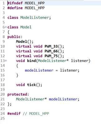

To be clear, you mean that the function that is first declared (the smallest line number) is called and never the 2 others?
(This is correct. In Model.hpp, only the first function of line 10 is called. If I switch 10 with 11/12, only line 10 of that function is called. Line 11/12 function still aren't called. Both functions work but, only when at Line 10.
 I am sorry, I do not understand this sentence. As I step through the call of the virtual functions, I'm able to do so until, Presenter to Model. Meaning something is taking place in between that I can't see what is taking place.

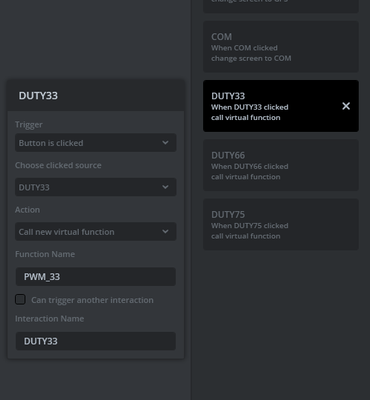

Can you also share the code of the view and presenter? (both hpp and cpp).
That's were you can specify what should happen. From the presenter you can connect to the Model to call the correct method.
Hi EmbDev,
Upon your request, the code follows: Same problem with the touchgfx upgrade (4.23.1). Also, I realized that the problem occurs from the presenter to model. FYI

Hello @Hiram Hyman ,
1) Formatting
I reformatted you post.
When providing code, make sure to use the "Insert/edit sample code" button.
2) Function name and type
I have seen  that you name all your function the same whether they are in view, presenter or model. Furthermore, they are all virtual so they can be overwritten. Finally, you say that you overwrite that function in another file. Therefore, every single one of those functions are overwritten.
3) What to do now
I would advise you to try to narrow down the issue and to follow best practices by creating a simple project from scratch where you try to add  3 buttons and print something from the model to make sure you are able to access all 3 functions.
From there you can include your MTR file that you use to overwrite the functions and instead of overwriting them, you can just call those functions from the model since you included the file.
