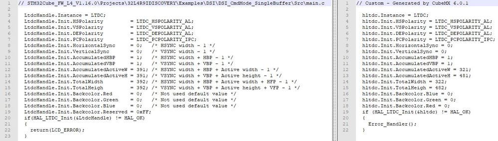

I have a custom board with an STM32L4R9 connected to a display (320x480) with internal GRAM over DSI. I've been successful in configuring and controlling the display using the HAL DSI API. Now I would like to use the LTDC to feed the DSI controller but have not been successful in getting anything to show up on the display.
The LTDC is configured with:
Display Type: RGB666 (18 bits) - DSI Mode
Layer 0 Pixel Format: RGB565 (corresponding to TouchGFX)
I'm trying to use the LTDC as follows:
  uint16_t buf565[320*480];
  for (uint32_t i = 0; i < (320 * 480); i++)
	  buf565[i] = 0x1f00;
  LTDC_LayerCfgTypeDef pLayerCfg = {0};
  pLayerCfg.WindowX0 = 0;
	pLayerCfg.WindowX1 = 320;
	pLayerCfg.WindowY0 = 0;
	pLayerCfg.WindowY1 = 480;
	pLayerCfg.PixelFormat = LTDC_PIXEL_FORMAT_RGB565;
	pLayerCfg.Alpha = 0;
	pLayerCfg.Alpha0 = 0;
	pLayerCfg.BlendingFactor1 = LTDC_BLENDING_FACTOR1_CA;
	pLayerCfg.BlendingFactor2 = LTDC_BLENDING_FACTOR2_CA;
	pLayerCfg.FBStartAdress = (uint32_t) buf565;
	pLayerCfg.ImageWidth = 320;
	pLayerCfg.ImageHeight = 480;
	pLayerCfg.Backcolor.Blue = 0;
	pLayerCfg.Backcolor.Green = 0;
	pLayerCfg.Backcolor.Red = 0;
	HAL_LTDC_ConfigLayer(&hltdc, &pLayerCfg, 0);
	HAL_DSI_Refresh(&hdsi);
Any help in figuring out where I'm going wrong would be greatly appreciated!

Sure. That's handled in this CubeMX generated function.
void MX_LTDC_Init(void)
  LTDC_LayerCfgTypeDef pLayerCfg1 = {0};
  hltdc.Instance = LTDC;
  hltdc.Init.HSPolarity = LTDC_HSPOLARITY_AL;
  hltdc.Init.VSPolarity = LTDC_VSPOLARITY_AL;
  hltdc.Init.DEPolarity = LTDC_DEPOLARITY_AL;
  hltdc.Init.PCPolarity = LTDC_PCPOLARITY_IPC;
  hltdc.Init.HorizontalSync = 0;
  hltdc.Init.VerticalSync = 0;
  hltdc.Init.AccumulatedHBP = 1;
  hltdc.Init.AccumulatedVBP = 1;
  hltdc.Init.AccumulatedActiveW = 321;
  hltdc.Init.AccumulatedActiveH = 481;
  hltdc.Init.TotalWidth = 322;
  hltdc.Init.TotalHeigh = 482;
  hltdc.Init.Backcolor.Blue = 0;
  hltdc.Init.Backcolor.Green = 0;
  hltdc.Init.Backcolor.Red = 0;
  if (HAL_LTDC_Init(&hltdc) != HAL_OK)
    Error_Handler();
  pLayerCfg.FBStartAdress = 0;
  pLayerCfg.ImageWidth = 0;
  pLayerCfg.ImageHeight = 0;
  if (HAL_LTDC_ConfigLayer(&hltdc, &pLayerCfg, 0) != HAL_OK)
    Error_Handler();
  pLayerCfg1.WindowX0 = 0;
  pLayerCfg1.WindowX1 = 0;
  pLayerCfg1.WindowY0 = 0;
  pLayerCfg1.WindowY1 = 0;
  pLayerCfg1.PixelFormat = LTDC_PIXEL_FORMAT_ARGB8888;
  pLayerCfg1.Alpha = 0;
  pLayerCfg1.Alpha0 = 0;
  pLayerCfg1.BlendingFactor1 = LTDC_BLENDING_FACTOR1_CA;
  pLayerCfg1.BlendingFactor2 = LTDC_BLENDING_FACTOR2_CA;
  pLayerCfg1.FBStartAdress = 0;
  pLayerCfg1.ImageWidth = 0;
  pLayerCfg1.ImageHeight = 0;
  pLayerCfg1.Backcolor.Blue = 0;
  pLayerCfg1.Backcolor.Green = 0;
  pLayerCfg1.Backcolor.Red = 0;
  if (HAL_LTDC_ConfigLayer(&hltdc, &pLayerCfg1, 1) != HAL_OK)
    Error_Handler();
  if (HAL_LTDC_SetPitch(&hltdc, 0, 0) != HAL_OK)
    Error_Handler();
  if (HAL_LTDC_SetPitch(&hltdc, 0, 1) != HAL_OK)
    Error_Handler();

According to the ST documentation (DSIHOST presentation and AN4860) using LTDC with DSI in Adapted Command Mode is the most efficient way to control a display with internal GRAM. That's exactly what I'm trying to do. I believe HSYNC and VSYNC are solely related to Video mode which wouldn't apply.
I assumed since the window for the second layer was 0,0,0,0 it wouldn't have any impact. I test this by commenting out those sections of the function but there was no change in functionality.
I am familiar with partial frame buffers as well as the merits of different pixel formats which I can consider once I have the display functional.

I did compare with the DSI example project and it appears that the code generated by CubeMX for the LTDC configuration is consistent as the example shows 0 for the HSYNC and VSYNC values.
You show CubeFW example, but i speak about Touchgfx generated examples, this show part from my 4.15 when i select 469DISCO as target,
for your display is this better example as when i generate same way over TouchGFX without cube example for L4R9, where you have right sync is 0 for 390x390 display but MX_DSIHOST_DSI_Init have big diference for this two displays examples. Too 4R9 uses GFXMMU ...

The only significant differences I see are the changes introduced by setting VSYNC and HSYNC to 1.
hltdc.Init.HorizontalSync = 1;
 hltdc.Init.VerticalSync = 1;
 hltdc.Init.AccumulatedHBP = 2;
 hltdc.Init.AccumulatedVBP = 2;
 hltdc.Init.AccumulatedActiveW = 202;
 hltdc.Init.AccumulatedActiveH = 482;
 hltdc.Init.TotalWidth = 203;
 hltdc.Init.TotalHeigh = 483;
Using the same logic, I modified my code but observed no difference in the output.
