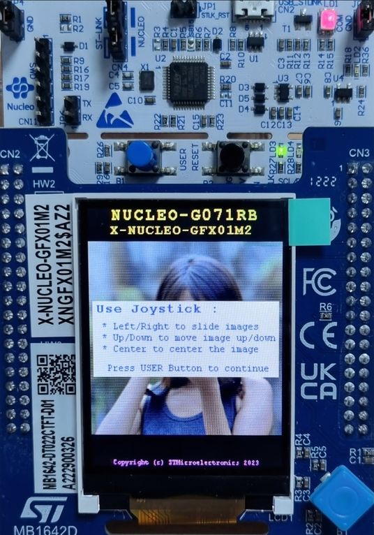

maplestream
Hello Jiannong Zhou.
I am also testing with the NUCLEO-G071RB + X-NUCLEO-GFX01M2 ($AZ2) combination.
As you said, AZ1 and AZ2 of X-NUCLEO-GFX01M2 have different LCD and LCD Driver IC.
1. X-NUCLEO-GFX01M1
1.1 XNGFX01M1$AZ1
This product identification is based on board MB1642-DT022CTFT-B01.
The LCD used in this product is DT022CTFT with driver IC ILI9341V.
2. X-NUCLEO-GFX01M2
2.1 XNGFX01M2$AZ1
This product identification is based on board MB1642-TCXD022IB5-D01.
The LCD used in this product is TCXD022IBLON-5 with driver IC ST7789V.
2.2 XNGFX01M2$AZ2
This product identification is based on board MB1642-DT022CTFT-D01.
However, AZ2's LCD and LCD Driver IC are the same as X-NUCLEO-GFX01M1.
So, if you use the two projects in the en.X-CUBE-DISPLAY.3.0.0.zip file (example), you can create a project for AZ2.
STM32CubeIDE\en.X-CUBE-DISPLAY.3.0.0\Projects\NUCLEO-G071RB\Applications\
- GFX01M1_HelloWorld
- GFX01M2_HelloWorld
The task basically uses the GFX01M2_HelloWorld project.
1. Copy 'lcd_io.c' and 'lcd_io.h' in the 'GFX01M1_HelloWorld\DISPLAY\Target folder to the GFX01M2_HelloWorld\DISPLAY\Target' folder. (overwrite)
2. Modify the following contents in 'en.X-CUBE-DISPLAY.3.0.0\Projects\NUCLEO-G071RB\Applications\GFX01M2_HelloWorld\Core\Inc\RTE_Components.h' file.
#define DISPLAY_LCD_COMP_ST7789V -> #define DISPLAY_LCD_COMP_ILI9341
3. In the folder 'en.X-CUBE-DISPLAY.3.0.0\Projects\NUCLEO-G071RB\Applications\GFX01M2_HelloWorld\STM32CubeIDE'
Open '.cproject' and '.project' files and modify all ST7789V related paths to ILI9341 paths.
4. Open the project with STM32CubeIDE.
5. Run the build
6. If there is no error after building, select 'en.X-CUBE-DISPLAY.3.0.0\Utilities\PC_Software\ExternalLoader\MX25L6433F_GFX01M2_STM32G0.stldr' for external loaders.
Then you can run the GFX01M2_HelloWorld project in your environment.
good luck.
Regards.
