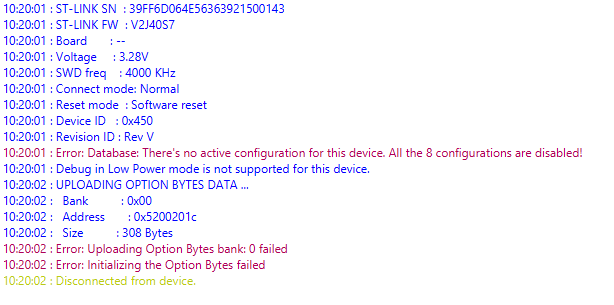

I've bought the Riverdi RVT70HSSNWC00-B STM32H7 embedded display.
But i'm unable to flash my app to the board.
Here are the log from touchGFX :

And here are the log from STM32CubeProgrammer:
0693W00000Y7NGvQAN.pngI'm a very beginner workins with STM32 and don't finda lot about these.
Can someone help me please ?
I've found the solution. I used the ST-LINK/V2 Isolated version between the boardand my PC but it needs the non-isolated version of it to works. I took one on a nucleo board and it works weel.
Thanks for your answers @MM..1​ !

Try change Connect mode to Under reset
I'm facing the same issue. And now I've a new error above "Error: Database..." :
"Error : Unable to get core ID"
Try latest 2.12 version prog or an older.
