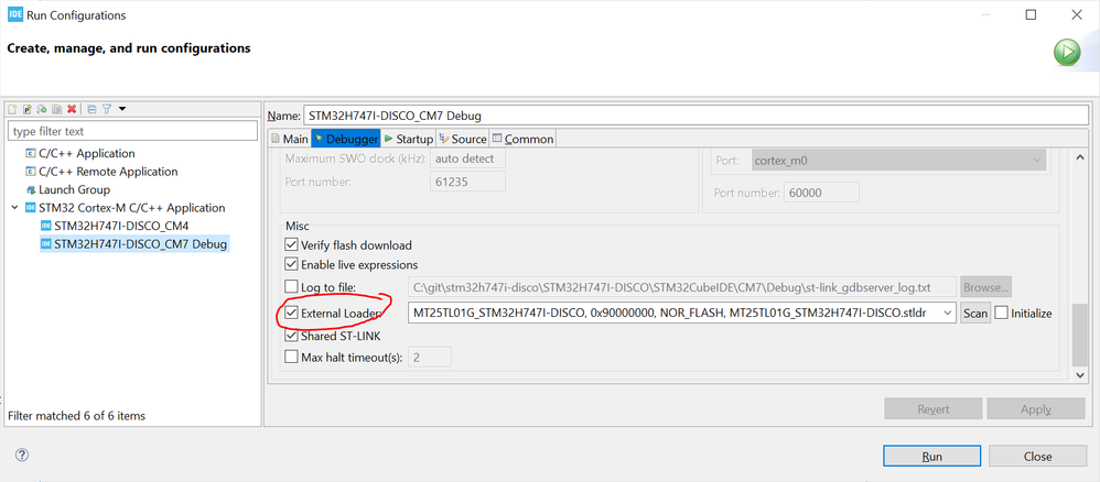

NDr
One day off to think... :)
The hardware architecture of the board contains external flash memory.
This is used to store texts, fonts and images of a TouchGFX application.
The root cause of the error message Error: failed to download Segment as well as the Cube IDE error message did not become relevant in the first test, because neither texts, images nor fonts were used.
Only in the second test (with a simple text) it is necessary to feed the external memory with data.
In other words... I just forgot to use an external loader when flashing.
After I configured the appropriate External Loader in Cube IDE, the download works fine.
However, one issue remains.
I did not find a way to specify an external loader within TouchGFX Designer.
Therefore it is not possible for me to flash the firmware using the designer.
However, this is not a big deal for me.
