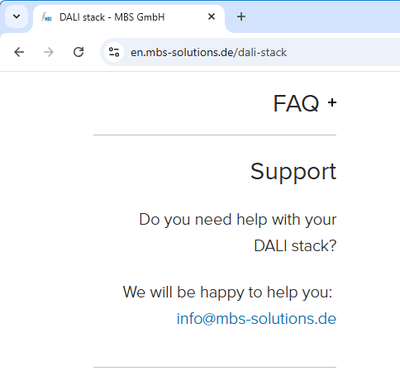

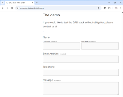

@ilcontefabio wrote:
MBS DALI library
You mean this: https://en.mbs-solutions.de/dali-stack ?
is there any application examples using their API.
You should ask MBS that!
See also: https://www.mbs-support.de/
They offer a Demo:
https://en.mbs-solutions.de/service-by-mbs
https://en.mbs-solutions.de/kontakt
