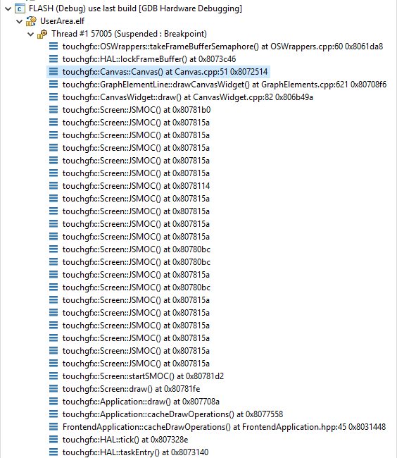

When switching between screens fast, my UI always ends up freezing. Debugging reveals that it waits forever, waiting for the frame buffer semaphore.
Here is the call stack:
Inspecting other running tasks shows nothing wrong. Only the graphics task should touch the frame buffer semaphore, right? So it should never deadlock?

‎2021-06-25 7:49 AM
@Martin KJELDSEN​ : another stack trace if it helps.
doesn't look like the problem is just with text widgets.

Additional point:
As far as I understand, normally you cache all possible widgets in the current active screen and then the draw calls from these cached widgets are invoked by cacheDrawOperations(). Thereafter the cacheDrawOperations() locks the framebuffer.
If there are more widgets in current active screen that are not cached then these widgets try to draw on its own and therefore lock the framebuffer individually.
If I am not wrong, the current failure occurs when framebuffer is already locked by cacheDrawOperations() and before this lock is released some other non-cached widget is locking the framebuffer again and therefore this deadlock.
Could this possibly happen ?
one more point to note here is that, this error is more frequently seen when optimizations is enabled. Does touchgfx has any problem when optimizations() are enabled ?
Would you like to have a look at our project ?
