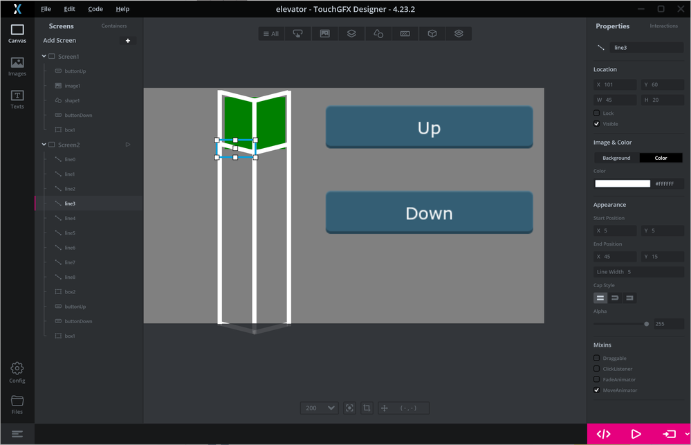

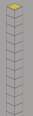

I have a requirement to create an elevator animation based on user input.
I have a 3D image representing a single floor, and I am using it in a container to create a scroll list for multiple floors. However, because of the 3D image, there is a gap between the floors, which is causing issues.
Please find the attached images showing the actual output and the desired output. How can I manage this gap effectively?

I am Using Transparent Image for Box
But it reflected on main page as attached file
It looks like a vector image with a few straight and a few diagonal lines. You can use inkscape to draw the vector image and then export it as svg or as png. So a single image.
Another solution is to use the line object in TouchGFX. The floors are 3 vertical lines in total and 2 diagonal lines per floor (+ 4 extra for top floor).

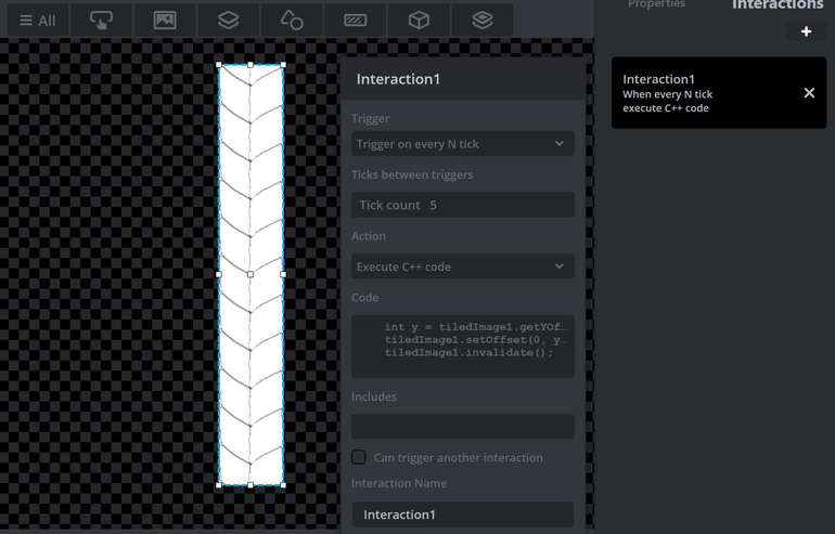

Is it possible using custom container.?
My tip start with tiled image + Special image on top + cabin image ...
read Tiled Image | TouchGFX Documentation
