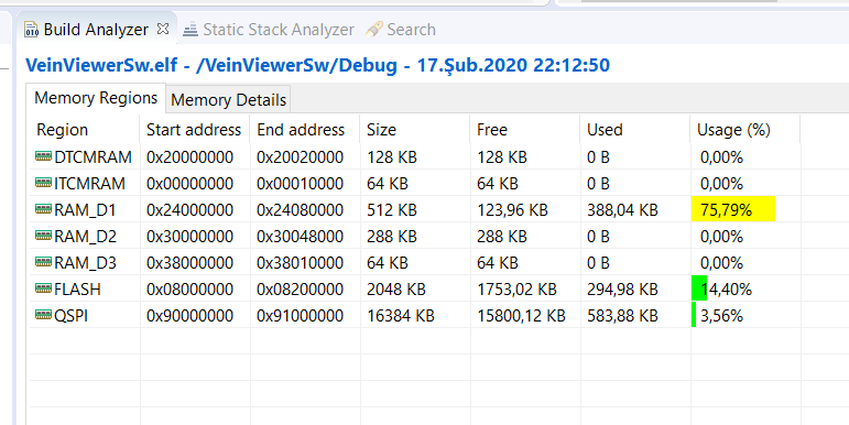

scottSD
Lead
Does the QUADSPI show up on your Build Analzyer?
Also, another time I saw the debug "MI" issue, I was actually out of hard drive space on my computer. I cleared up some space and it worked.
KERDO.1
I used internal memory for pictures and code works, but now gui task doesnt call flushFrameBuffer();
