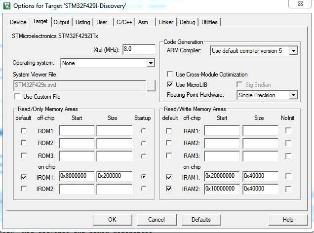

(3) Un-comment "#define SINGLE_FRAME_BUFFER_INTERNAL" for the internal flash and SRAM use (which causes problem!)
with the 3rd change, I'm getting Hard fault
My, target MCU is STM32F429ZI having 2MB flash and 256+4KB SRAM
I'm using keil MDK 5 for as IDE
Here is the memory footprint after compilation code on keil5
Code =  57840  bytes
RO-data= 565412  bytes
RW-data= 2500   bytes
ZI-data=215644
RW-data=2500
For "Option for Target", i have attached in screen shot
Stack_Size EQU   0x5000
Heap_Size   EQU   0x200
FreeRTOS task heap size 2000kb
From the memory footprint, i can say that it should be easily fitted with my MCU, but unfortunately that's not happening!

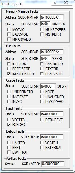

The functions at where I'm getting hard-fault is shown here
Bitmap::registerBitmapDatabase(BitmapDatabase::getInstance(),
                                   BitmapDatabase::getInstanceSize(),
                                   bitmapCache,
                                   bitmapCacheSize,
                                   numberOfDynamicBitmaps);
/*  Calling from Above BitmapDatabse Function */
namespace BitmapDatabase
const touchgfx::Bitmap::BitmapData* getInstance()
    return bitmap_database;                                                    <--------------Cause Hardfault
uint16_t getInstanceSize()
    return (uint16_t)(sizeof(bitmap_database) / sizeof(touchgfx::Bitmap::BitmapData));
@Martin KJELDSEN​ Can you give me any suggestions ?
Here is the hardfault report
Eagerly waiting for your feedback
