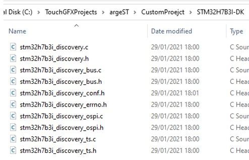

Then I copied STM32H7B3I-DK folder from same directory and deleted unnecessary files.These 9 files are needed.

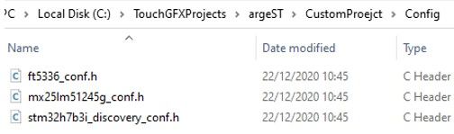

After that I created a folder to copy files from original project in Core/Inc.

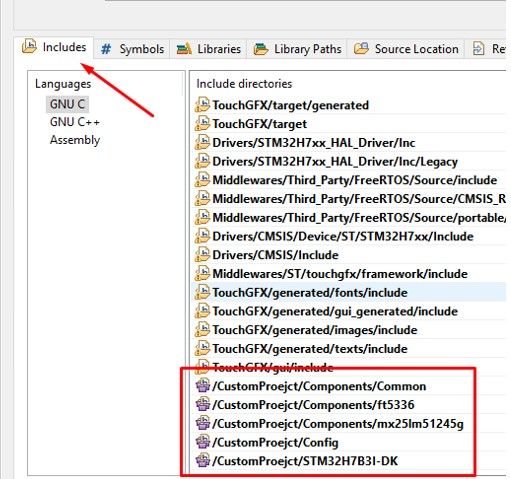

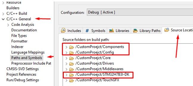

Then in the CubeIDE I add those folders as Source Location and Includes otherwise we cant have correct output files and my problem was this.
Then I added this files to Includes for both C and C++.
