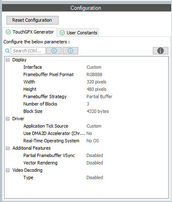

I have designed a custom board based on a STM32WB35CE and want to use TouchGFX with it.
I have enabled the TouchGFX Middleware in STM32CubeMX:
and used the resulting ApplicationTemplate.touchgfx.part file to create a blank user interface with TouchGFX Designer and generated code.
When building the code the linker throws the following error message:

I was eventually able to fix this issue by recreating the project from the .ioc file. Same workflow as before:
  • generate code with CubeMX
  • create blank user interface and generate code with TouchGFX Designer
  • generate code with CubeMX again
but no linker issues this time. I'll take it.
