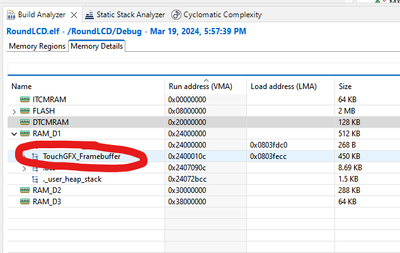

* First I've check the framebuffer, if it could be allocated properly. And I think it is.

pLayerCfg.FBStartAdress = 0x2400010c;

I made sure that I've the correct address of the framebuffer.

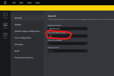

I've found that Board Setup is N/A. Does it have to do with blank screens?
2024-03-22 6:15 AM
Hello @Emre2blue ,
Are you using the Board Setup that is available in TouchGFX, or, have you created a custom project from ground up?
If you are using a custom project, can you first confirm that your display is set up correctly and that you can show a simple color on it?
There are plenty of documentations about the process available here
Also, having TouchGFX Board Setup set to N/A, does not cause any issues, so, don't worry about that.

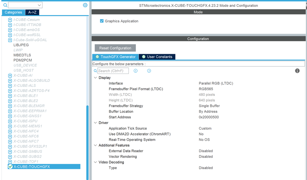

A good place to start investigating is to ensure the framebuffer is filled correctly. I am a bit confused by your statement that you had to find the address manually. When you are using LTDC, you don't need to manage the communication between TouchGFX and the display through the display drivers. TouchGFXHAL is responsible for that, and if you need to make changes, they should be applied there. As for the address of the framebuffer, you can either specify the address directly from the STM32CubeMX project under Middleware and Software Packs -> X-CUBE-TOUCHGFX -> Display-> Buffer Location (setting it to By Address), or from the linker script (which requires setting the Buffer Location to By Allocation).
Framebuffer location
Then you need to generate the code from STM32CubeMX again.
I suggest you start with an extremely simple UI (like having only one green box), check if the framebuffer contains the correct value, and then move on to a more complex project.
