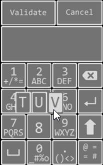

Hello @Maximiliano ,
Is it the T9 keyboard?
The simplest way to understand the keyboard is to look at the name of the textArea that displays the text and to look for it in the code. This way, you can see when we update it.
From memory, when a key is selected, the selected key value is sent from the KeyContainer to the KeyboardContainer, then a function is called to update the textArea.
For you, you simply have to modify the function updating the textArea with the function I shared above.
Also, you could completely remove the textArea and the bow between the "Validate" "Cancel" button and the keys since you want to put the characters directly in your own textArea.
I hope this clarify things and give you a starting point.

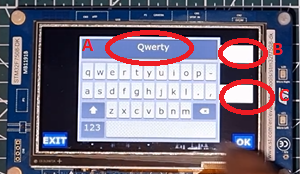

I started my code from the youtuber controllerstech (I attach a picture of how he implements the keyboard he makes by taking the keyboard from the touchGFX examples).
In the screenshot I indicate different text areas where (A) is the text that fills the keyboard at the moment key by key before passing it to some text area (B) or (C).
actually I managed to implement a code that saves the buffer in a variable and in the text area (B) or (C) that saves with “*” hiding the text. but my difficulty is how to make it also hide in the text area (A) of the keyboard itself. if I can do that later I will see how to do so that I can press a key and it shows the text or shows hidden with “*”.
the code simply consists of clicking on a text area, typing on the keyboard and if the ok button is pressed, the keyboard buffer is passed to the variable corresponding to the text area, otherwise it is discarded.
I tried to send you a trimmed code so you won't find too much code making noise,
hopefully the code I'm sending you will help you understand how I'm using the keyboard since I started from there.
what I am not able to understand is how to hide or not the text that is being entered in the area (A) before giving ok or exit with the character “*”.
