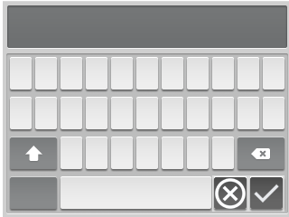

Hi
I am using the TouchGFX keyboard to input data into fields on a number of settings screens. Since the screens are small, I cannot afford the option of Cancel and Enter buttons as used in the demo. Instead I have added 2 buttons to the keyboard for Enter and Cancel. The former leaves the buffer intact, while the latter clears it before returning. However, the function that contains the keyboard container continues executing while the keyboard is in use. The result is that the data is never entered into the field.
One workaround I have used is to add an 'Add/Edit' flex button  that loads the keyboard and writes the returned buffer to the model. Flex buttons over the data fields, that are made visible at the time the keyboard container is loaded, then cause the screen to reload, which then draws and displays the data from the model. It works, but it is too clunky.
I have tried using a while loop to pause while the keyboard is visible, but this does nothing.
Has anyone any suggestions on how to pause the code until the user has finished entering data via the keyboard? I'm probably missing something extremely obvious.

Hello @Kenbit ,
Which keyboard are you using?
I do not understand this sentence "the function that contains the keyboard container continues executing while the keyboard is in use". What is the function that "contains" the keyboard? Isn't it supposed to keep running for it to properly work?
You say that you don't have much space so you removed the buttons and added other ones. They seems to do the same thing, I assume you replaced them with smaller buttons then. Can't you simply resize the buttons provided?
Also, if you can't resize the provided buttons, can't you just call whichever function the initial buttons were calling?
"how to pause the code until the user has finished entering data via the keyboard?"
This seems like the wrong way of doing it. One doesn't not want to pause code, otherwise, wouldn't your application freeze and the user won't be able to enter text?
Can you share a project with an example of the issue you are facing?

Hi Gaetan
Thanks for getting back to me.
Sometimes defining the problem becomes part of the problem.
The project is running on the STM32F429 DISC1 board. It uses FreeRTOS
I am using an amended form of the customKeyboard example in one of the TouchGFX demo projects. However, I have shortened the space bar and edited the keyboard to include an OK (tick) button and a cancel button.
keyboard minus the buttons.keyboard minus the buttons.
These are part of the keyboard, not external buttons like in the demo project. I am taking this approach as my display is 320*240, as is the keyboard.
The code snippet shows what I want to do.  However, lines 14 onwards are all executed while the keyboard is visible, so nothing is copied into the text area. I want this function to wait until the keyboard is cleared and the buffer contains the entered text. Waiting for the keyboard to clear and the buffer filled would not be an issue as the RTOS scheduler could switch to other tasks if needed.
Code is greatly abridged to save space. There are multiple text fields.

Is there a way to conveniently pause the first example until the keyboard entry is complete?  The keyboard is an object of class CustomKeyboard, which is made visible via a flex button on the screen and normally hidden by the external buttons. The second method above emulates this external button idea, but hides the keyboard from within the keyboard code. Would a semaphore work here? I am also using the keyboard from other screens.
I hope this gives enough clarity.
Regards
Ken

Hello @Kenbit ,
Ok, I see which one it is.
I have answered another question regarding this keyboard here .
He wanted to display '*' instead of the characters but keep the data entered by the user.
So we went for 2 buffers, a new one to save the data and the one provided in the original code to display the *.
I am still not sure what the issue is.
You want to be able to press the "V" button and save the string entered by the user?
In that case, is there anything blocking you from first sending/copying/printing the buffer and then deleting the keyboard?
Reading you question again, I do not understand this :
"However, lines 14 onwards are all executed while the keyboard is visible, so nothing is copied into the text area. I want this function to wait until the keyboard is cleared and the buffer contains the entered text. Waiting for the keyboard to clear and the buffer filled would not be an issue as the RTOS scheduler could switch to other tasks if needed. "
The keyboard example do not use textArea, so the textArea you are referring to must be the one you created yourself. But I do not understand why nothing would be copied, the keyboard being visible or not should not affect that.
I do not know what a semaphore would change, to me this is not part of the problem.
If you want to go in "modeless", it means that everything can be clicked right?
Because modal is when a sub windows open, only that windows can be clicked but you want the opposite.
So in your case, the window is the keyboard I guess.
TouchGFX is already in modeless. Because if you add a small widget in a big screen, all the other visible widgets can be interacted with.
So I think I still don't understand the issue. :grinning_face_with_sweat:

you should really wrap your head around the concepts. touchgfx (like every gui) is more an event style system. so while-loops and pausing something are red flags and most of the time not the correct solution.
and sorry but the description of your problem is not ideal and it's hard to get what you are trying to achieve
you have no space for ok/cancel buttons? but you added them to the keyboard?!
When is your keyboard entry complete? after 1 char? after 5 chars? or when the user presses ok?
i just looked at https://www.youtube.com/watch?v=Tkz9099a7a4 how this keyboard is meant to be used. as far as i understand your ok/cancel button are part of the keyboard keys and not extra buttons. so in the keyboard eventhandler you need to disinguish which button was pressed. if it was ok than you need to check if your requirements(eg. 5 chars entered) are already met.
in the solution in the video there are extra buttons with their own event handler which is only called if exactly this button was pressed so you don't need to differentiate which button you pressed
another tip: if you have many widgets/elements you can combine them in containers. so you can just hide the one container if needed (i don't think you will need this here)

i dont't think the keyboard runs in its own task. it's party of the touchgfx gui task all running in the same task. just waiting for touch events and showing the gui
if you have multiple screens which needs the keyboard data (you can't show all screens at once) you have to propagate the data entered by the keyboard to the model and if you switch screens, that screen has to get the data from the model and show it.
November 26, 2024
i don't get what you mean with "the system moves on"
when you/the user presses [ENTER] you have to generate an event/a message/whatever which copies the Textbuffer and sends it to the e.g. model, copies the text to another text window or whatever you want to do with it.
no need to wait or something like that
November 26, 2024
me neither.
i think one of the conceptual problems where you need to wrap your head arround is: there is no active waiting. there are no user do- while-for() loops in your gui code.
you just react to events . in this case: on every key onClicked() event you want to decide what to do.
for the keyboard it seems to be  setKeyListener() where you can set a callback and then you will be notified on every keypress and can decide if it was the enter/exit button or just transfer the text already entered to the model. (but this only works if the addational keys are part of the keyboard)
if the two buttons are seperate buttons than handle it in their event onClick() handlers. so in the onClicked() handler of your ok button you can check if your requirements are met, propagate the text already entered to where ever you want, etc

The code is now updated and working exactly as I wanted, with all five textAreas filling and data saving to the model. Now I just need to see how to get the keyboard working with 2 screens. Another day.
Thanks Again
