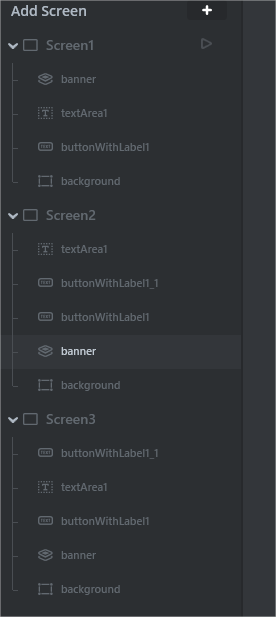

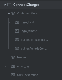

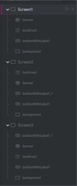

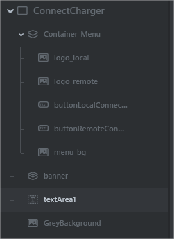

‎2022-08-12 4:14 AM
Hello @Yoann KLEIN​ ,
I have found where the problem comes from but I'd like to know why and if possible for TouchGFX to correct the problem or tell me how to prevent it.
I have my Banner as a custom Container. I have other widgets like images, buttons and texts in my screen.
Here's the screencap of the layout. The clocks don't behave as they should here.

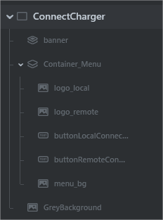

When I put the banner just below my container, above my background image, suddenly the clocks work as they should.

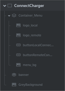

Now I first thought it was because of my normal container. So I tried to add an other image below my banner. When I did that, the clocks stopped working correctly.

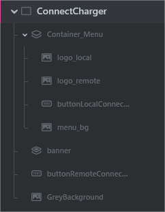

So I thought. Is that a problem with having two images below my banner? So I tried with any other widget like button or other text. Same think, it's still not working.
So I thought it was because of the number of widgets below my banner. I tried changing the background image by a button and it stopped working.
Any image works : here for example, the clocks are perfect.
So I concluded that you could only use one image below the banner or the clocks would stop working properly.
My question is, how do I manage for my clocks to work if I want to put my custom container on top of all my other widgets?
Thanks in advance,
Eve

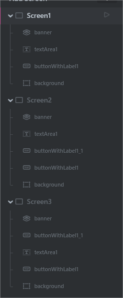

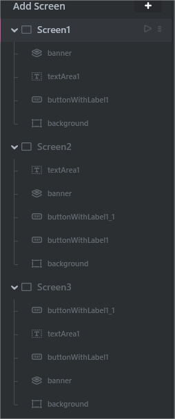

‎2022-09-05 2:42 AM
I have found out maybe a clue that could help us:
No problems between the screens if you put the banner at the exact same position in the 3 screens (here for example position number 4 but it also works when everything is in position 2)
But the moment I change this (for example 4th position in screen 1 and 5th in screen 2 and 3), the moment I switch from screen 1 to 2, the counter is starting at 0 on screen 2 and increments perfectly between screen 2 and 3 no matter how many times I change. When I get back to screen 1, it counts on its own counter (starting from where it left off the previous time we were in screen 1). I therefore think that there is one counter keeping in memory where it is for screen 1 and one other counter keeping also in memory where it is for screens 2 and 3.
But something else happens when I choose positions s1:4, s2:4, s3:2,
Screen 1 → screen 2 : everything goes well, continues counting.
Screen 2 → screen 3: starts back at 00:00:00 (cnt=0).
Screen 3 → screen 2: 14:10:30 (cnt=0) not like the first example when it started back from where it left off in screen1.
Other example s1:4, s2:2, s3:2
Screen 1 → screen 2 : gets back to 00:00:00 (cnt=0)
Screen 2 → screen 3: continues counting from the time of screen 2 so for example 00:00:25 (cnt=25)
Screen 3 → screen 2: same, continues counting
Screen 2 → screen 1: 15:00:27 (cnt=0)
I didn't manage to get the counter initialized to 7620 like you, it always came back to 0 when there was a problem with the time.
I'm really wondering if there isn't different tick counters based on the position the custom container is in.
