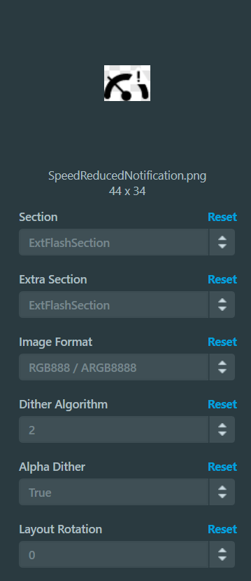

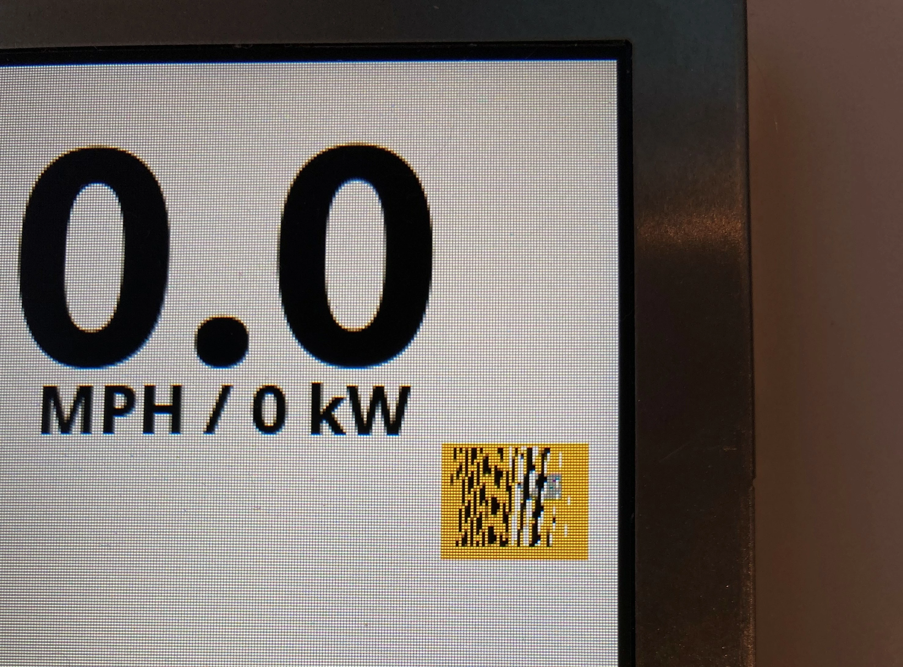

TouchGFX seems to mangle all of my .png images. The image is loaded directly into the flash and mapped in BitmapDatabase.cpp. Nothing special going on. Has anyone encountered this or have any troubleshooting ideas?

‎2021-01-12 9:49 AM
Looks like the correct answer was to set the image rotation to 90 deg. Thanks @MM..1​. I must have missed why this when setting up my Default Image Configuration: https://support.touchgfx.com/docs/development/ui-development/designer-user-guide/config-view#default-image-configuration

No @Alexandre RENOUX​ i report this bug here, when you set image angle 90 first build generate fail image, Changing angle twice correct this.
as here png-data does not show properly on the TouchGFX "Run Simulator" (st.com)
Or @ you set bad rotation 0 and need 90

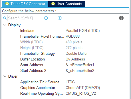

My environment includes:
- TouchGFX 4.15
- Firmware Package STM32Cube FW_H7 V1.6.0
- Target: STM32H753 with 480*272 display
- Quadruple Framebuffer (Double framebuffer with corresponding inverted framebuffers for 180 deg screen rotation.)
- Images are marked for ExtFlashSection, but that is currently being loaded into the normal flash area. It appears to be loaded correctly.

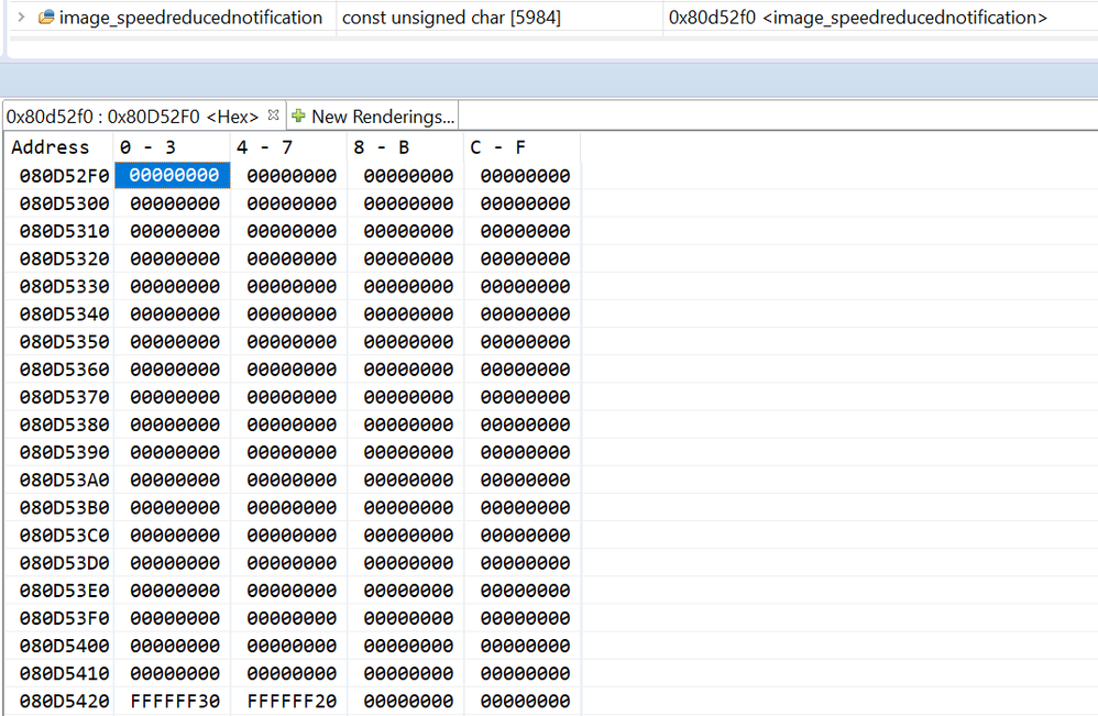

ExtFlashSection :
*(ExtFlashSection ExtFlashSection.*)
*(.gnu.linkonce.r.*)
. = ALIGN(0x4);
} >FLASH
// 4.15.0 0x2c2e7c8c D2 AY R0 FARGB8888 U888 N0 SExtFlashSection
// Generated by imageconverter. Please, do not edit!
#include <touchgfx/hal/Config.hpp>
LOCATION_PRAGMA("ExtFlashSection")
KEEP extern const unsigned char image_speedreducednotification[] LOCATION_ATTRIBUTE("ExtFlashSection") = // 44x34 ARGB8888 pixels.
0x00, 0x00, 0x00, 0x00, 0x00, 0x00, 0x00, 0x00, 0x00, 0x00, 0x00, 0x00,
0x00, 0x00, 0x00, 0x00, 0xff, 0xff, 0xff, 0x30, 0xff, 0xff, 0xff, 0x20,
Here is the original .png image:

Hmm try check display orientation in touchgfx config, is here landscape or portrait? When landscape set your png to angle 90 not 0.
Second is your quad buff , touchgfx dont support 180 , better for mcu is use rotation over display controller IC, or use two screens one 0 second 180.
‎2021-01-12 9:49 AM
Is there any reason why this setting does not automatically attach to Display Orientation in Config -> Display?
