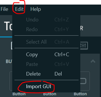

‎2020-08-19 12:06 AM
Yes this is understandable sorry, the code is quite complex, especially in Demo 1 where you have multiple types of Graphs. The code for the graph in Demo 2 is easier to understand since it is shorter :grinning_face_with_sweat: , but the graph widget will simplify everyone's life once it comes out.
But concerning the configuration what do you mean? Since the demos/UI examples are made with the Simulator you can import them to your custom projects and test them by using the "import GUI" function in the "Edit Tab" when you are working on Designer. Would this help you test it?
