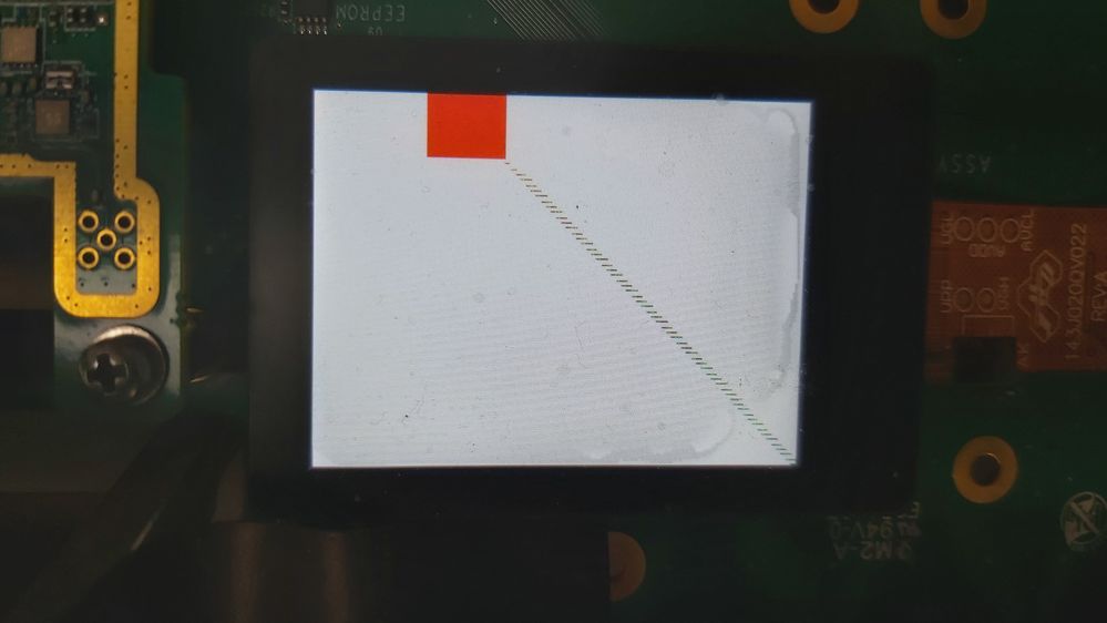

touchGFX function startMoveAnimation is leaving dots in the path. why ?

it is not happening on simulator. only on my real target !
Eblec.1
is there any initialization that is running on simulator and NOT on my real target ?
Eblec.1
today I tried this on evaluation board stm32l496g-disco and it works ok without dots left behind.
the disco has a screen 240*240. my screen is 320*240. can it be the reason to the dots left behind ?

Hello @Eblec.1​ ,
What do you mean with leaving dots in the path ? Could you provide more details about your issue and maybe also screenshots ?

hello, Yoann.
I added an image that shows the dots left by the animation of moving the box through the screen.
thanks.

Hello Eblec,
Try use <box>.invalidate() for the background box and execute it in each tick event

thanks. I'll try this. but isn't it a workaround to fix an animation problem ?

Hello Eblec.1,
You said that on the stm32l496g-disco it works fine but on which board it's not working fine ?

hello, Oskt.
it works fine on the disco, which has 240*240 screen.
it leaves dots on my custom board with a screen 320*240.
I declare in touchGFX the 320*240 , and only the animation leaves dots.
