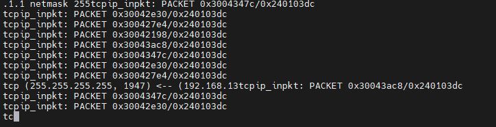

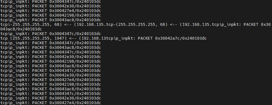

Following some screenshots capturated from logger terminal
Screenshot1:
Starting program and init lwip done (no any attempt to access to ip address)

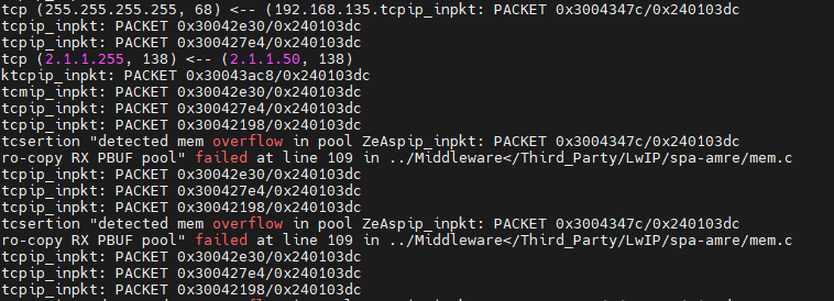

Screenshot 2: Sending ping  (with success !!)
Comment: as you can see there's some warning checking mempool, but i'm not able to understand how to avoid them..i tried to increase stacks, mem_buf etc.. but no any success
All seems to be ok, i can ping, connect, disconnect from port 502 (IP address 2.1.1.1)...but logs continue to show that warnings

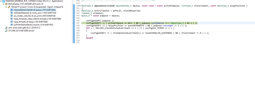

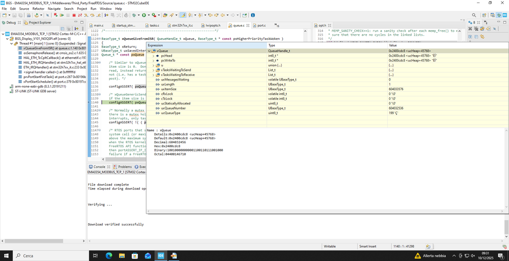

Then  I tried to simply connect to port 502. Then my program stuck and go in assert (screenshot3)
Screenshot 3

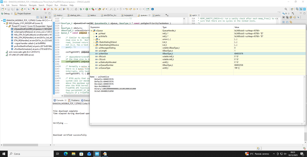

In screenshots 4 and 5 you can see the variables related to line that cause the assert:
As you can see, the code fall in assert becouse the variable xqueue->uxItemSize = 0x2400d224.
That memory position is part of allocated memory in heap_4.o module (part of freertos)
Here part of .map file
                0x0000000024001afc        0x4 ./Middlewares/Third_Party/FreeRTOS/Source/portable/GCC/ARM_CM4F/port.o
 .bss.ucHeap    0x0000000024001b00     0xbb80 ./Middlewares/Third_Party/FreeRTOS/Source/portable/MemMang/heap_4.o
 .bss.xStart    0x000000002400d680        0x8 ./Middlewares/Third_Party/FreeRTOS/Source/portable/MemMang/heap_4.o
 .bss.pxEnd     0x000000002400d688        0x4 ./Middlewares/Third_Party/FreeRTOS/Source/portable/MemMang/heap_4.o
The strange is that if I ping 2.1.1.1 then I connect to port the program don't fall on assert... (but I still see warning as in screenshot 2..)
Instead, if I connect to port without ping before, I always fall on asserts.

A short upgrade:
warnings  in screenshot 2 of previous message  disappeared if I set in lwipopts.h:
//#define ETH_RX_BUFFER_SIZE 1536
#define ETH_RX_BUFFER_SIZE 1568
But, I'm still having assert like explained in previous message (see screenshots 3...to 5)
