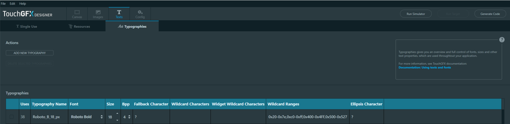

Hi there,
as stated in the subject, it looks like the "Table_" fonts files are not updated when the ellispsis charaters are changed in the designer typographies tab. As a result the structures "static touchgfx::GeneratedFont" are not inited with the proper ellipsis characters.
Is this a bug or I'm missing something?
I'm using Designer v4.16.1
Regards

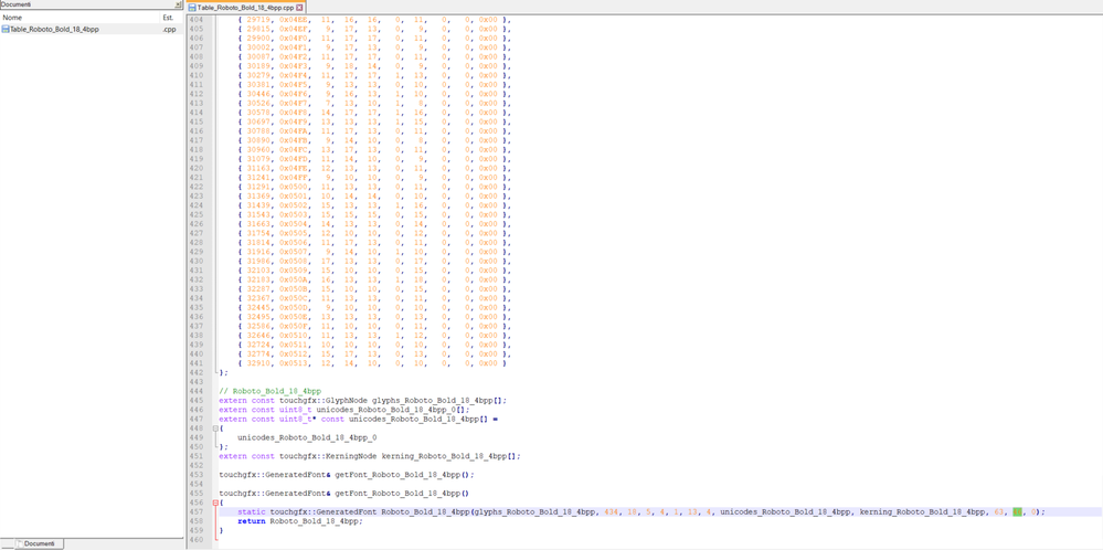

I changed the "Ellipsis Character" from '.' to '?' and generated the code (note that there is no "blue point" beside the "Generate Code" button)
In spite of that, the generated font is still inited with the '.' as the ellipsis character. As you can see in the screenshot below, the twelfth parameter of the
static touchgfx::GeneratedFont Roboto_Bold_18_4bpp
is still equal to 46 == 0x2E == '.'
