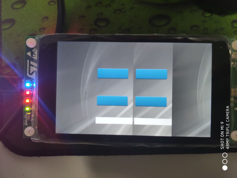

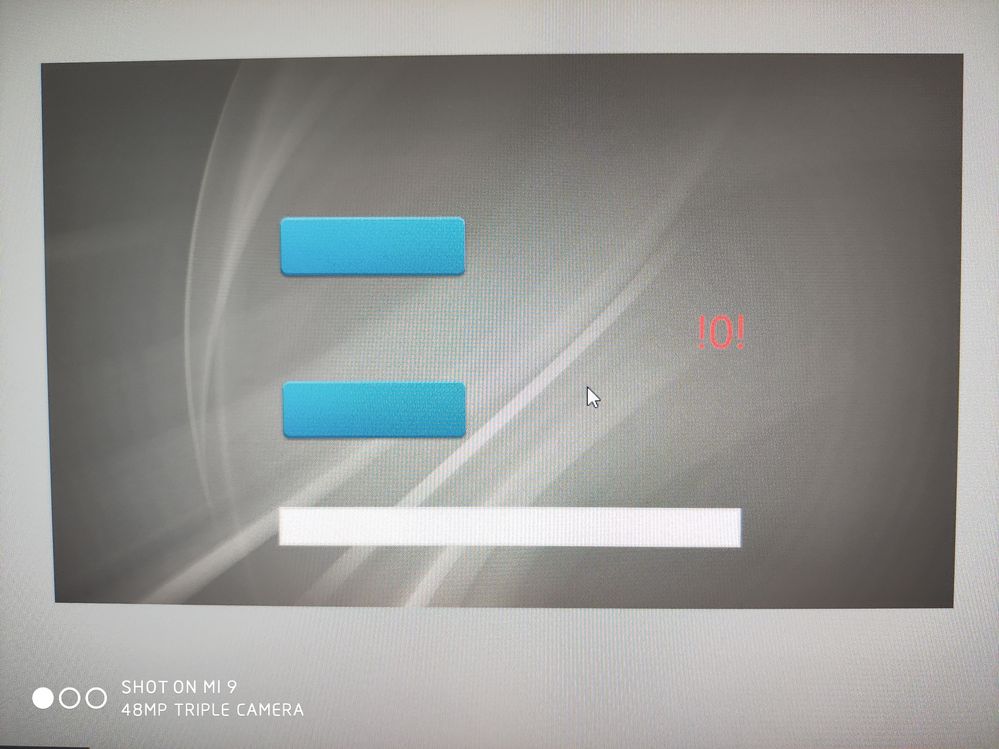

So for now there is no way we can use F469-DISCO on CubeMX combining with TouchGFX?
https://touchgfx.zendesk.com/hc/en-us/articles/360020208091-Configuring-STM32F769I-DISCO
I tried to follow this doc cause these two boards have the same LCD,but i only got half of the screen working fine.I think i'm on the right way ,but just can't get there.Pics shown below.
Any time schedule about fixing this?

Hi @QZ Lee​ it wasn't easy, but I was able to use CubeIDE and TouchGFX togheter for the STM32F469I-DISCO.
I hope I will have time to prepare a short guide.
Coming back to your problem I suppose that it is due to :
 HAL_LTDC_SetPitch(&hltdc, 400, 0); -> must be set to 800
so to fix the problem use these settings in file HW_Init.cpp :

 HAL_LTDC_SetPitch(&hltdc, 800, 0);
Please, let me know if it works.
