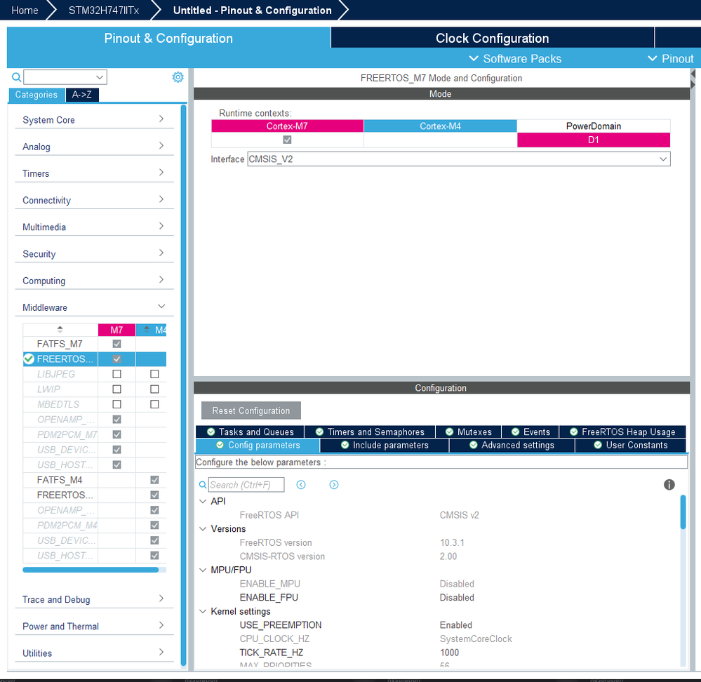

Hi Martin,
Thanks for the help! Do you recommend using ChibiOS in the CubeMX IDE or should I do all my work in CubeMX and then copy all of the file to the ChibiOS dev environment and then build from there?
If moving ChibiOS into the CubeMX dev environment is the way to go, is there a guide on how to do that?
Thanks!
Daniel
DOkaz.1
@Martin KJELDSEN​ @Osman SOYKURT​ Just to confirm, I need to choose FREERTOS in the code generator (as well as configuring everything needed), enabling CMVIS_V1/CMIS_V2 (Probably will go with V2 since it seems cross-compatible and if I go multi core it'll be required) and then manually moving the needed generated files into ChibiOS (removing the FreeRtos specific stuff) and starting a new TouchGFX task for it?
Once I have the CubeMX configuration, i can generate TouchGFX applications using that config and also add it to the ChibiOS.
Is there any steps that I'm missing?
Thanks!
Osman SOYKURT
Hello DOkaz.1,
Yes it seems to fine with this steps. @Martin KJELDSEN​ can you confirm ?
/Osman
