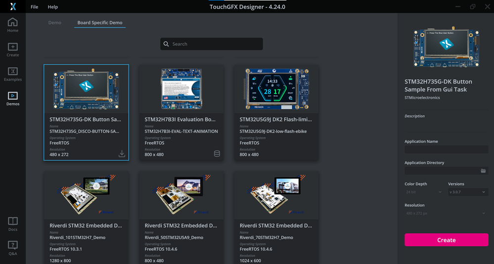

In addition, you can get inspiration from the Board Specific Demo available for STM32H735G-DK, so you can observe how communication between the frontend and backend is handled:
STM32H735G-DK Board Specific Demo
