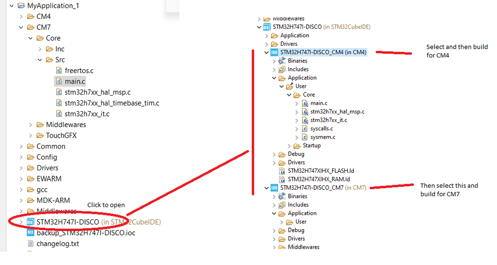

I am usual of Stm32CubeIde. I try first time TouchGFX V 4.21.3 with H747 DISCO.
TouchGFX simulator is well working. But after generating (clicking on the project icon in C:\TouchGFXProjects\MyApplication_1) the project in Stm32CubeIde, the build project is not possible. The reason seems to be no file 'MyApplication_1.ioc' .
I probably miss something. Thanks, if you could help.

Hello. I think like this you can compile your project:
BRobe.3
Thanks a lot.
Very clear. Working
